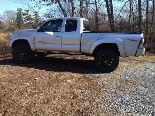

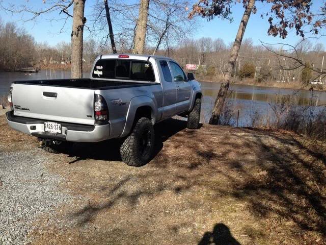

    Maybe i can help im running 285/70/17 duratracs on 17x9 , 5" backspace wheels. 5100's at 2.5, 1.5" 3 leaf progressive AAL, stock UCA's. I had to remove mudflaps and the little flaps in front of the front wheels, and i did have to slightly trim the inside of my fender. ill try to grab a pic of that. Currently not rubbing the Cab mount with this setup. I hear that i may rub it if i decide to get aftermarket UCA's but for now the truck tracks fine.

    I think it's rides just fine. Granted I had 2 jeeps before this so maybe my opinion if a rough ride is different then yours. I haven't tried any major flexing but as of now after fender trim no rubbing at all
