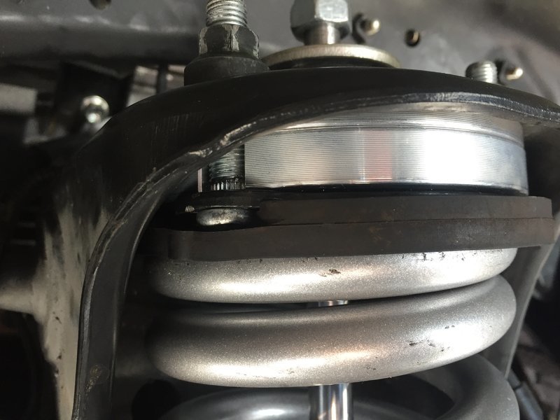

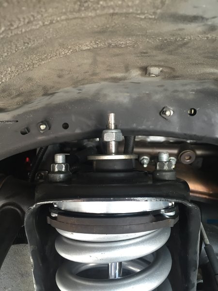

    so i installed the lift on my 2012 dcsb or 4x4 and have the c clip set at 1.75, added the spacer given and the coiler stud is going so far out the top of the boot that screwing the nut on top doesn't secure it at all. what to do? will add a picture as soon as i can

    did you re-use the original upper shock bushings?

    yes..do i need new ones? didn't see that anywhere in instructions and/or package details

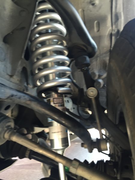

    Take some pics of what you're talking about and your entire strut assembly. We can better see what is going on.

    Did you install the black shock boot? There is a little metal sleeve inside the top of the shock boot that goes underneath all the rubber bushings and washers. that will pull the top of the shock stud down to be able to tighten properly.

    i did and will take a pic as soon as I'm out of class and get a chance to

    Looks like you left some pieces out. Lets see a pic of the entire strut assembly.

    Maybe missing the bushing on the bottom side of the top hat? That's really the only way you end up with this problem, is if you don't have enough 'stuff' installed on the bottom. (ie. washers, bushings, boot sleeve.)

    Can some post pics of parts to see if im actually missing something. Doesnt seem that im missing asnything cause i just to the old one of and put the new one on?

    yup you forgot the shock boot, the metal sleeve will take up that extra space

    So the picture that xJuice posted?

    This is what's missing. Those boots act as a spacer.

    Lol that means i hace to redo this shit for the 3rd time. The first time i didnt put the 1/2 spacers cause dodnt think i needed then. Then had that space and took everything apart, added the spacer last night amd just now noticing the space again.
