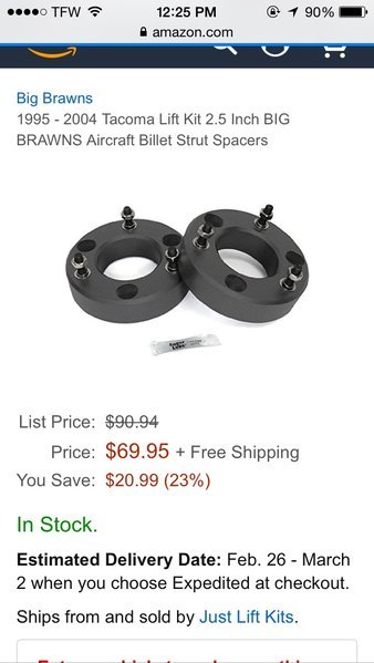

    Bump and not really related but I'm the OP so...
    Does anybody know anything about these? I have a friend who's running these and he's never had a problem.

    As long as you get spacers that are "top plate" spacers they are okay. Much much better than coil spacers that go inside the coil assembly, those preload the shit outta your coils and ride very harsh! No bueno on those!

    Okay where do those go that I posted a pic of lol. Y'all will have to excuse my ignorance because I will admit I don't know much about this stuff
