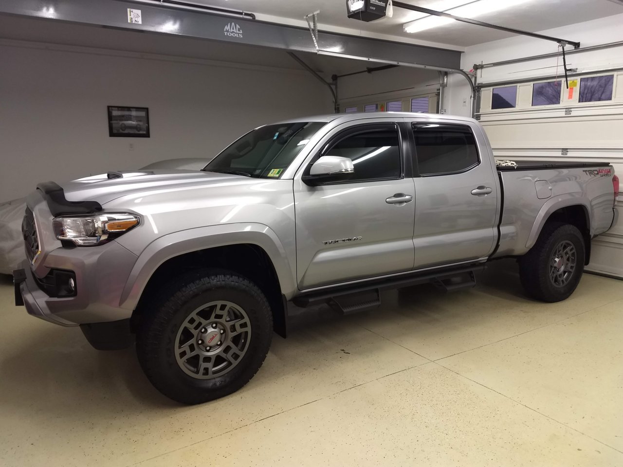

    Bilsteins 5100s on the top setting, 4runner Gray TRD Pro Sema wheels, 285/70/17 Toyo AT3s, Sumo Bump stops, TRD exhaust, ECGS Clamshell bushing, 1/4 shim for the lean and one inch rear block, OEM Pro grill and garnish OEM TRD Skid plate, TRD CAI, Demon Brackets, Rigid Industries Pro fog lights, OEM Trail Rails sidebars, Diode Dynamics LED SL1 high and low beam lights, OEM Roof racks, Clazzio leather heated seats, Remote Start, TRD Pro shift knob, tinted windows, Rockford Fosgate 4 channel amp for the headunit and sub and amp combo, OEM Puddle lights, OEM tailgate lock, OEM bed mat, LED interior lights, OEM blackout kit for letters, JLT catch can, upgraded 27F toyota True Start battery, Vleds led tail light kit with Pro tail lights, OEM Rave4 side mirrors with convex spotters,just to name a few mods.
    Don't waste your money on 888s they will sag, my friend is on his second set. Plus the 5100s work well with the factory coils and I run my 5100s on the stock Sport coils and stock UCA and alignment is perfect.
    2 1/2 up front and an inch block in the rear. The tires got me some more lift as well.

    I run mine on the 4th perch next to the top setting, 1/4 shim for the lean. Yes it rides great, better than the stock sport struts. Think of it like this, rides like a off road without any lean in the turns and no nose diving when breaking. The shop I used does a lot of these, recommend stock coils and the ride is great. I'm picky and very anal about things being cared for and in perfect order. My truck fits the bill for me. Yes a one inch rear block, rear carrier barring drop and a front diff drop as well. Alignment was perfect with stock uca, no rubbing, vibrations, no shakes, no issues what so ever. More than satisfied!

    Gratz, that is a beautiful ride. I have the same truck, but 2019 in Metallic Grey. I am wanting to add the SSO slimline hybrid brush guard and a winch. I am worried about the front dipping. My shocks are factory Bilstein 4800. I was looking at 5100s. You think only changing the shocks I will be good enough to compensate? I read the 5100s are adjustable. Sorry for interjecting on thread but similar conversation. Thanks.
