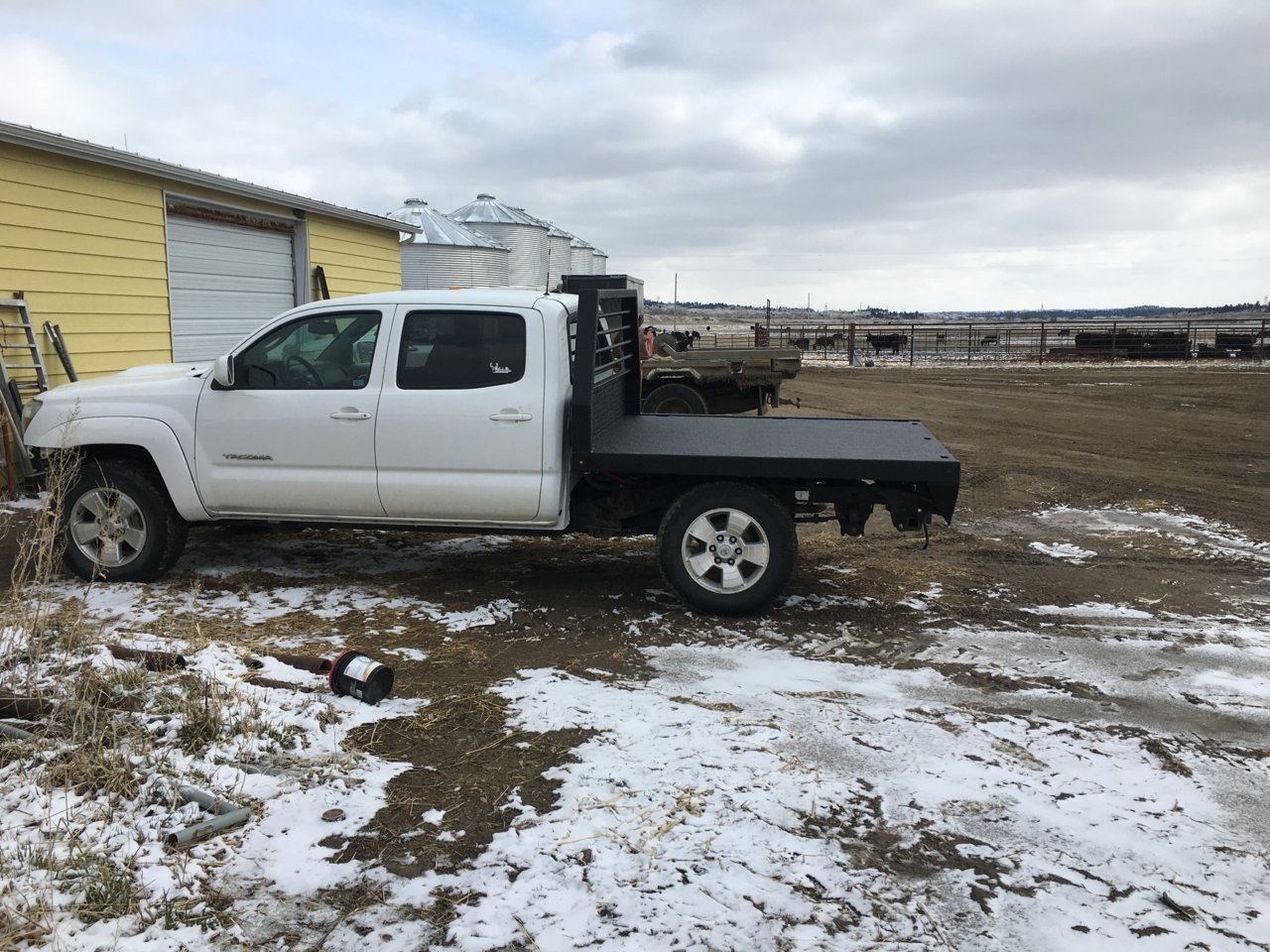

    So this is the flatbed it’s pretty heavy what’s your guys thought on the ome heavy duty leaf or what do you guys think E11B043F-CE42-41BD-A1AF-A7D174EF6E71.jpg

    Yeah I'd say you might even want to add another leaf to the HD pack.

    ^ good advice there
