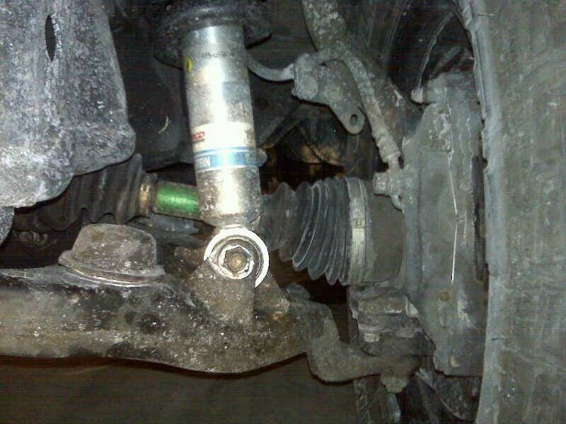

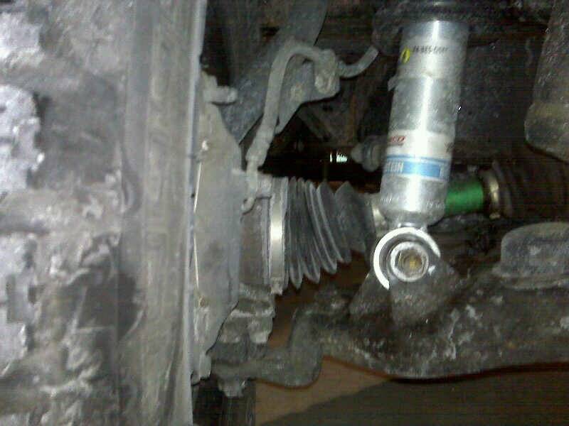

    Quick Pictures of the CV boots while in the Walmart parking lot tonight.
    Drivers Side
    Passenger Side

    Drivers Side CV
    Driver Side Upper Boot
    Passenger Side CV
    Passenger Side Upper Boot
    As you can see from the pictures from last night and tonight there is a little grease coming out from around the what I call the upper boot on the passenger side?
    **EDIT**
    ** Took the truck into the shop today, they drove it and thought noise was an alignment problem, as for the grease they think the boot was over filled and when the angle was changed the extra grease was forced out. They cleaned it up and told me to keep an eye on it. A little more has come out since, but not a whole lot. So I guess that is where it stands now." **
    Thanks!!

    hey, the truck looks great.
    one question: did you put in a diff drop?

    Yep I installed a diff drop. I don't know why there is so much angle. I got less than 3" of lift, really about 2.75". With the 881's and the Billies at 1" (middle setting)
