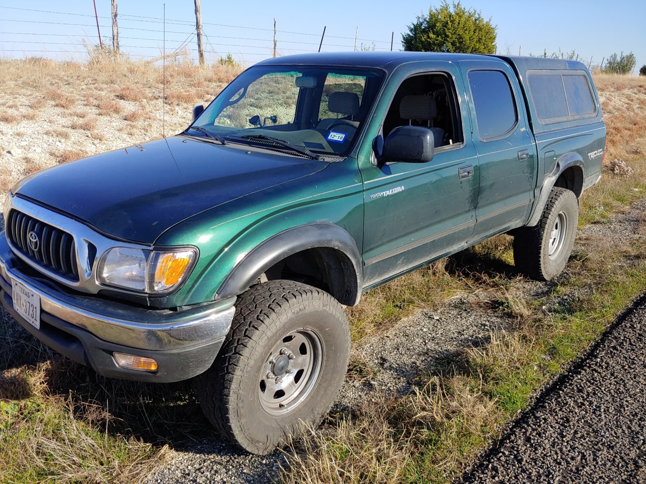

    2001 Tacoma double cab 4x4
    if you go with the 5100's and OME 881's from Low Range Off-Road, they ship everything for free on orders over 50 bucks (some exceptions but springs and shocks are free shipping) and their prices are very reasonable, competitive with many other online sellers. Moderately fast shipping, even if you're chomping at the bit to upgrade some tired old OE suspension, like I was. anyway, that's the setup I went with and I love the ride, mind you I was switching from OEM suspension that had 240k miles on it. It rides great on the road and this is after I removed the sway bar too, not too much body roll even in corners but the off-roadability of it is amazing. I recently had the opportunuty to do some moderately serious off-roading on a "small" thousand acre ranch down near Junction, TX. and the truck (suspension) performed very well. the rear leaf springs were the dakar OME set with the poly non-greasable bushings paired with 5100's. loved it, and it looks good too. i think so anyway

  5. Feb 10, 2019 at 7:15 PM
    #85
    steve2267
    steve2267 Small Mammal Fire Support Team
    Oct 31, 2013
    #115619
    638
    Steve
    Colorado
    04 Double Cab Tacoma 3.4L 4WD/TRD
    So you're running all-OME springs (881's out front, Dakars in the rear), but Bilstein's on all four corners?
    Why the poly non-greasable bushings? Everyone seems to say get the OME greasable bushings. Was that primarily for cost savings?
    Are you running 5100's in the back? Or did you get 5125's? If 5100's in the back, did you get any shock extenders?
    2nd to Last question: did you happen to get the D43XL extra leaf from OME to go with the Dakars?
    Last question: tire size?
    Thx.

  6. Feb 10, 2019 at 8:22 PM
    #86
    LazyEye
    LazyEye Active Member
    Oct 10, 2018
    #268973
    32
    Yes Bilstein's on all four corners, it was a significant cost savings for me at least, since my wife doesn't exactly see eye to eye with me on off-roading, so I look for all available cost savings I can as a way to lessen the impact on my wallet and therefore our budget. I don't remember the exact part number of the bilsteins but 5125 sounds familiar. nope, no shock extenders (I'm not even sure what those are, and I didn't take the time to look them up before I replied) I did not get the aal kit, although now that I've added a camper shell, I'm beginning to regret not getting them and am considering that in the near future since I do like a slight rake to the truck. current tire size is 32x11.5 R16, probably going to keep that tire size but go with MT's next. I really like the extra off-road grip and am more than willing to deal with any road noise. poly non-greasable bushings for cost savings once again as the poly greasable require a different set of shackles = more dinero.
