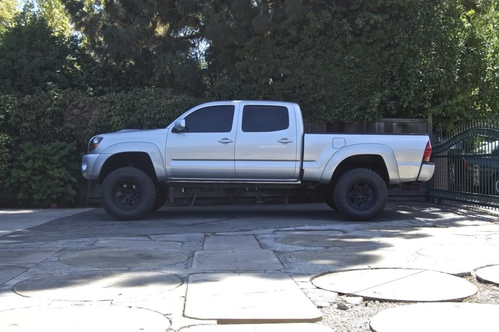

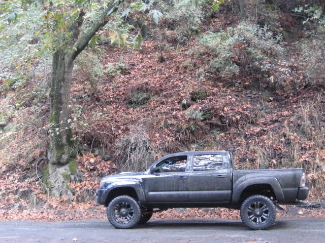

    Got some good feedback from Down South Motorsports (super quick response):
    1. 5100's set over ".0" with Coils will lead to alignment issues.
    2. 5100's set at ".0" will net about 2" of lift from the Coils.
    3. 5100's are made to run 265/70/17 or equivalent to 32" at 8" wide.
    4. Fiberglass fenders can help gain clearance.
    All that considered, here's the new plan:
    2010 Tacoma DC LB Sport 2WD
    Phase I:
    Maxtrac 4.0 Spindles
    1.5" AAL
    33/12.5/20 Nitto Trail
    20x9 Black Rhino Moab
    Phase II:
    Bilstein 5100's Front (1.75)
    Spidertrax Spacers 1.25" Front/Back
    1" Rear Block
    I love these setups
    Kenny650:
    HBtacoma:
    Here's the wheel/tire combo. The guy gave me crap about asking what size the tire was when I called--then said it was a 275--then checked and said 35, Looks like a 33 to me--Anyone?
