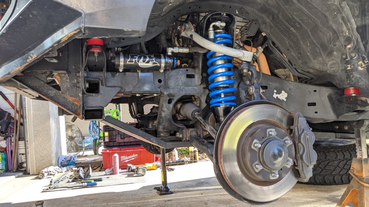

    I had 5100's with stock springs on top perch off-roaded once god awful, you lose a lot of up travel to coil bind and bottoming out feels like *samir you're breaking the car* and the street ride wasn't that great either, anyone whom claims it's the same doesn't pay much attention to how a vehicle actually handles.
    A few auto-x weekends teaches you a lot.
    I got 887's put on the bottom that was a good ride, then I added weight, had to move them up one clip which isn't recommend so now I'm on Fox 2.5's with 14" 700# coils and I LOVE LOVE LOVE IT.
    Still a little soft with the body roll which seems odd to me because there's hardly any brake dive at all.
    Even less than with stock weight and the 5100's with 887's.
