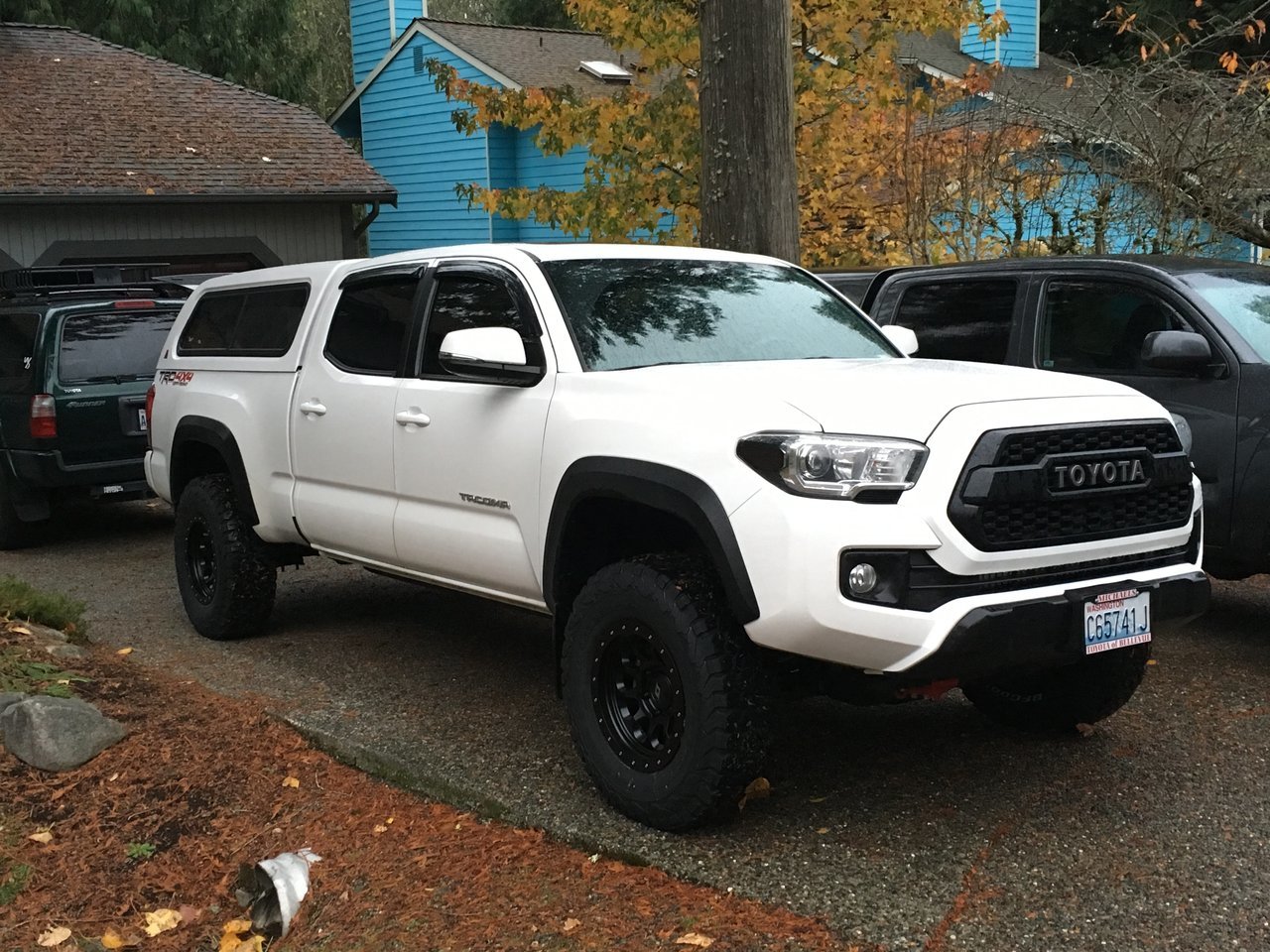

    2023 Sport 4x4 DCLB
    Toytec Alumaseries Coilovers OME El111R Camburg UCAs Scs sr8 17” 285/70/17 KO2
    5100 front on 3rd notch, stock coil.
    5100 rear with 1.5” block.
    Sits about level w the canopy on.
    265/75/16 ko2. Perfect size tire for that amount of lift imo. Also, that size tire is way more easily available if something happens and I need a replacement.

    I would do the 265 but I want something a little wider, and I unfortunately can’t run anything smaller than a 17in wheel on my Sport.

    Sick truck though! Can’t wait to get my hands on those exact SCS wheels!
