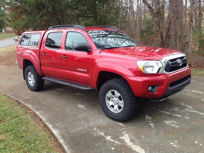

    5100's all around. Front's set at 1.75" 265/75/16 Duratracs.
    I did alot of research before ordering my Bilstein 5100's. They should be here today and installed tomorrow. From everything I looked at those are the best bang for the buck with very little problems ever. I am setting mine at 1.75" with 265/75/16 Duratracs on stock off road wheels. I will throw some pics up tomorrow when I get it back from the shop.

    enough to go over stuff
    That looks clean
