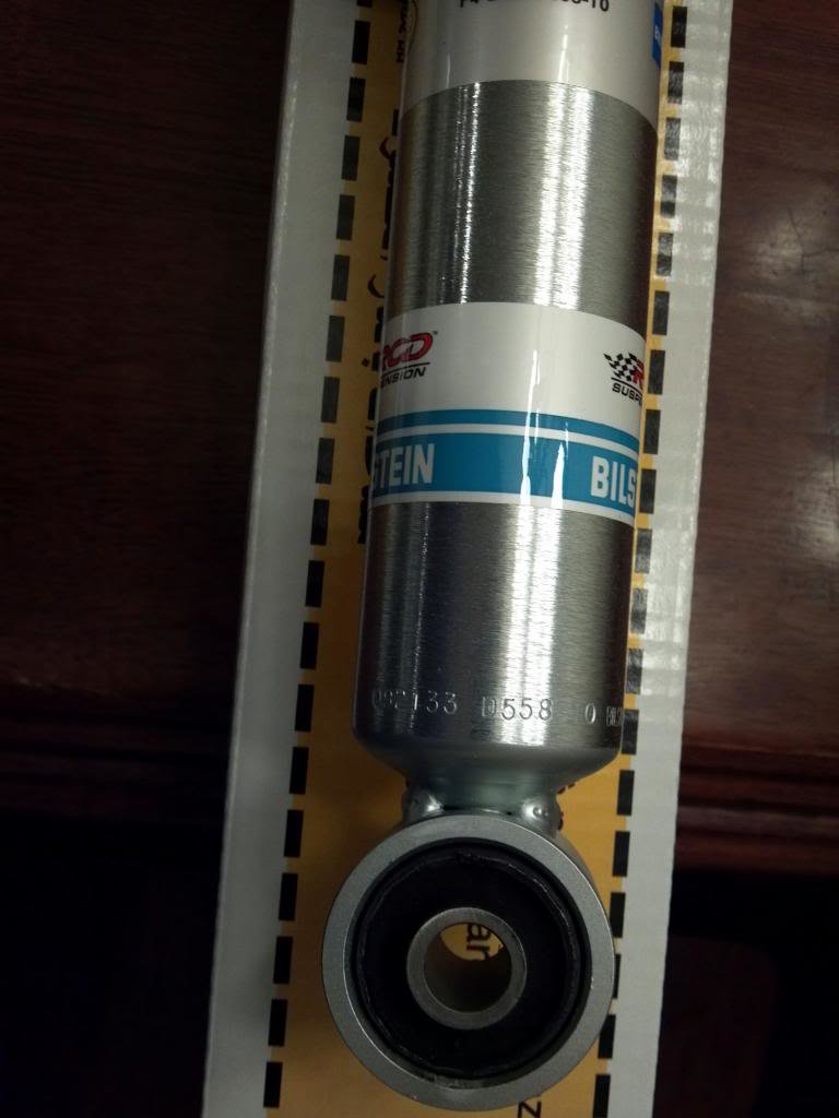

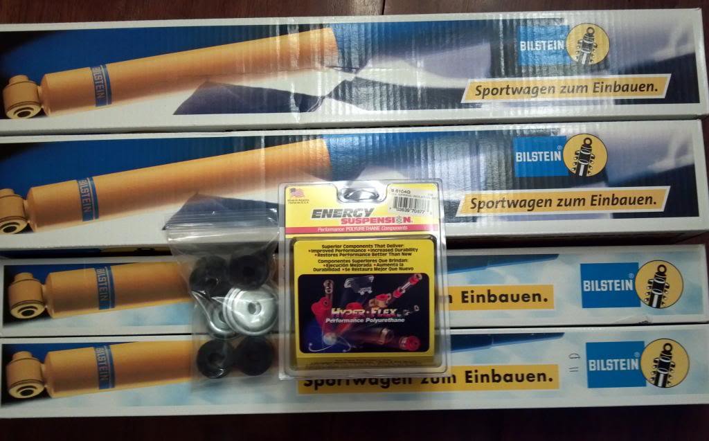

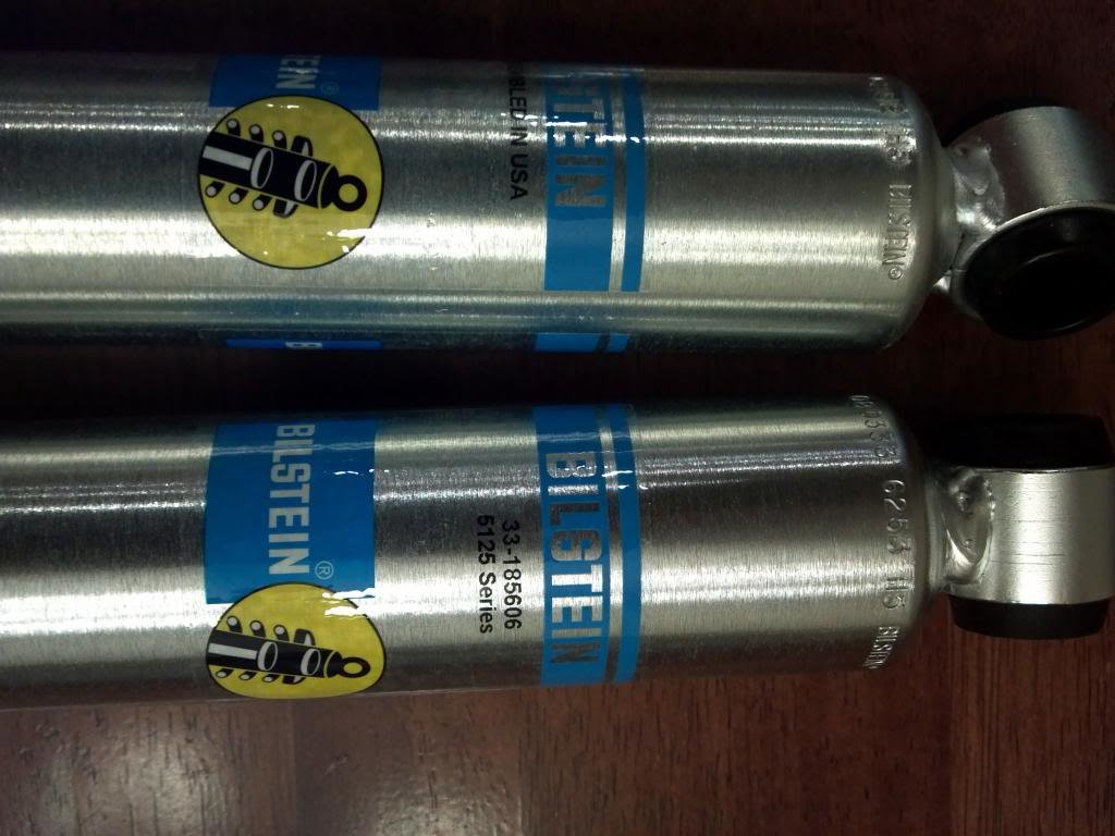

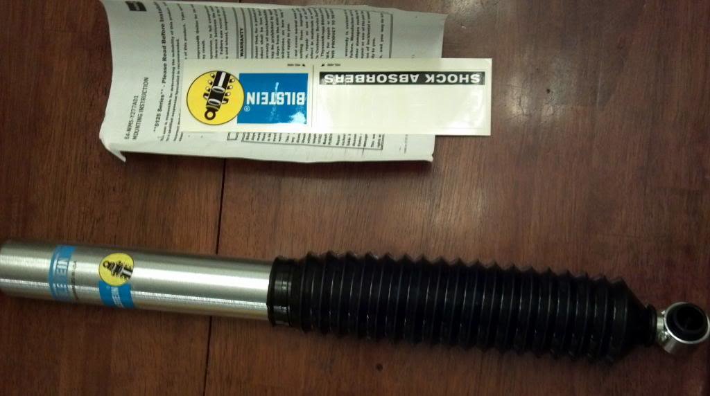

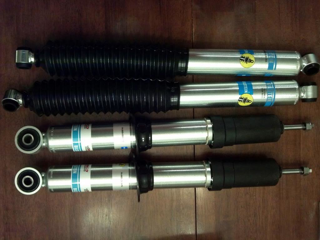

    Look what came in the mail!! :D:DHopefully the weather will be nice this weekend and not freezing in the Garage. Can't wait to get them on.
    For the past two nights I've been spraying some PB Blaster on the shock bolts to help loosen them up.
    One thing that surprised me is that the Front Shocks came with Bushings installed. At Downsouthmotorsports.com it states that the Front Shocks do not come with Dust Boots or any other bushings per Bilstein. I did order the the optional Dust Boot covers for the front so maybe they were included.
    More to come...............

    Primo man, the new Bilstein 5100's and 5125's are installed :D.
    As you stated, the rear shocks were pretty easy to replace.
    I had the Toyota Dealership replace the fronts and do a front end alignment.
    Notes on factory Bilstein's that were replaced.
    Top Rear Shock Mounts look new (Where shock mounts on frame)
    Bottom Rear Shock Mounts, especially passenger side were rusty
    Took a wire brush and cleaned off the rust best I could and brushed a layer of Loctite Rust Neutralizer before installing the 5125's.
    I've always heard that you don't realize how bad your shocks are until you replace them and that is so true. Just putting the rears on helped with the "Slinky" motion when turning.
    Just had the front shocks mounted today, and again, what a difference. I placed the 5100's at the lowest groove which is "Stock Height".
    It definitely appears to sit a little higher, but that's probably because the stock ones were sagging from being worn out.
    Would I recommend these to someone.........YES!!!

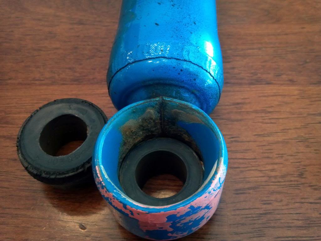

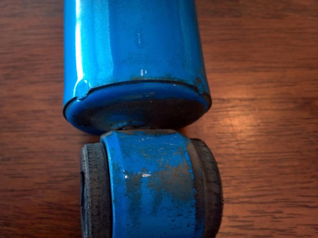

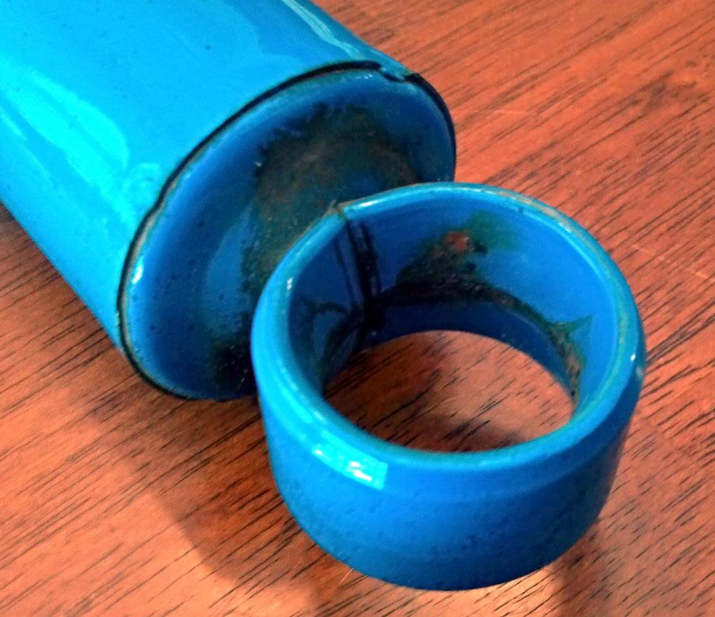

    I'll post of some pics of the stock front shocks that were removed later this week.
    Hopefully this weekend all the ice/snow will be off the roads where I can give her a bath and post some pics.

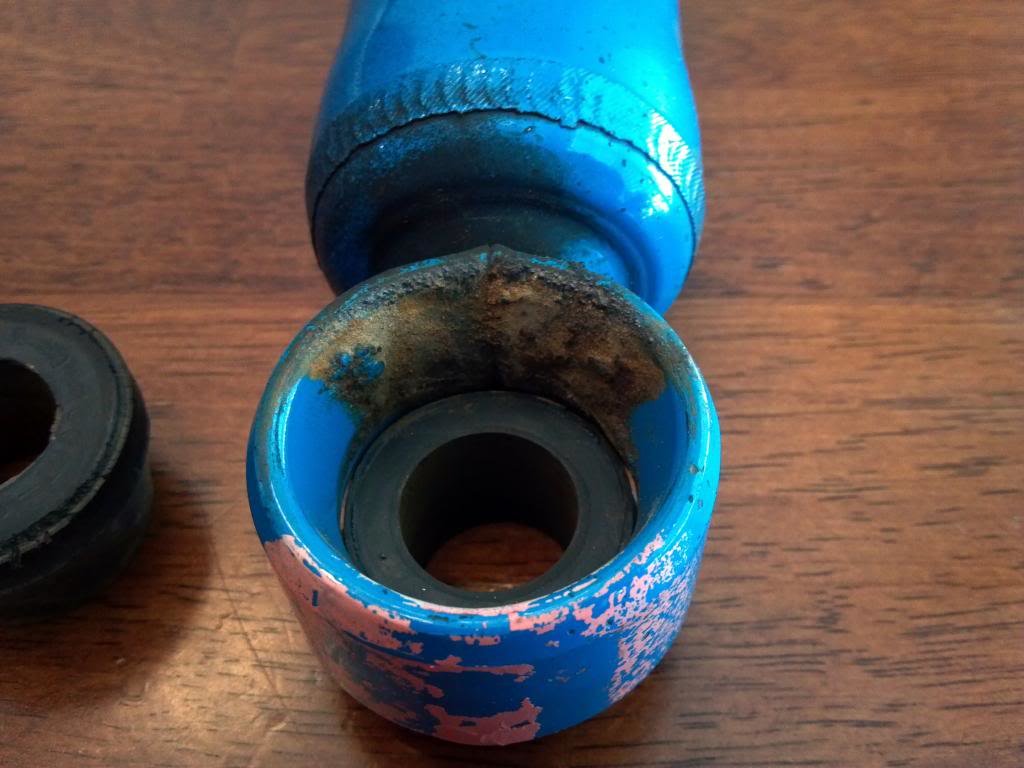

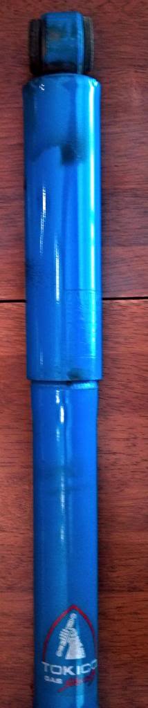

    Below are some pics of the stock rears. Compared to some I've seen replaced on the forum, they look pretty good after 105,000 miles.

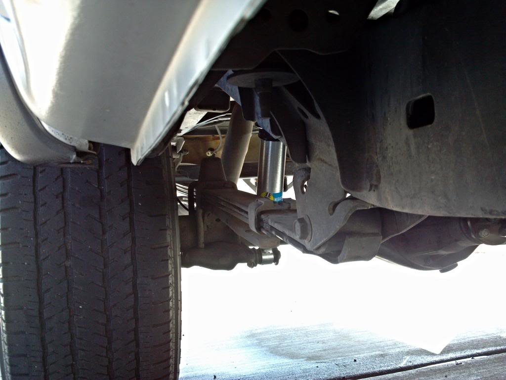

    Hey Drewski,
    Honestly I'm not sure what condition they are in. They "appear" ok in that they aren't covered in rust or broke. I took a couple of Pictures of the leaf springs for you to view.
    I had not put the spare tire back on when I took these so it's gives a good view of the rear underside. Hope this helps.
    Measurements from center of Hub to top of Fender is right at 21 5/8".

    The front shocks did come with Bushings. The picture of the other bushings/washers were from Toytec to replace the "cushion" bushings.
