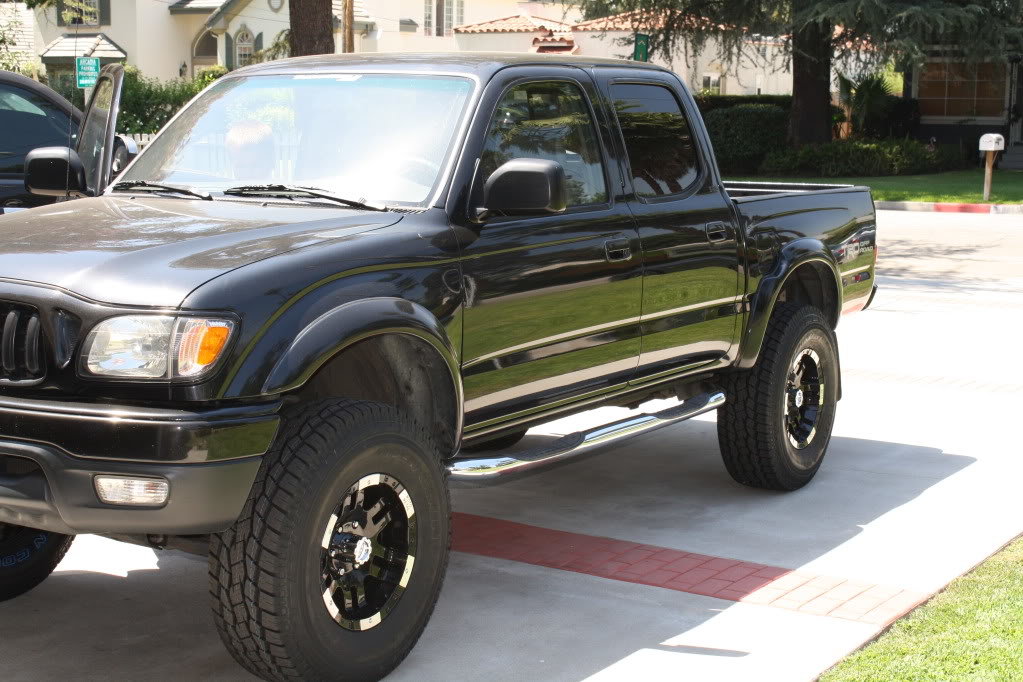

    Do you have any pics?

    Eibach/Toytec coils, bilstein 5100's all around, Kenwood DNX7100 Navigation
    my 03 with the eibach coils upfront paired with 5100's front and rear, and a 2" AAL in the rear.
