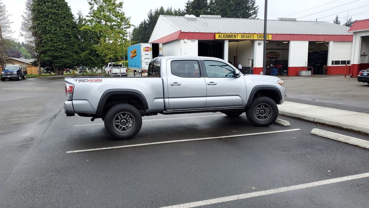

  20. Jun 3, 2020 at 8:29 AM
    #20
    JoelSolid
    JoelSolid Member
    Apr 19, 2020
    #325186
    10
    2019 Cement TRD Off Road
    I have the 5100s up front with a 2 inch lift. Rear is completely stock and it looks level to my eyes. I'm running 33 inch tires. I really like the combo.
