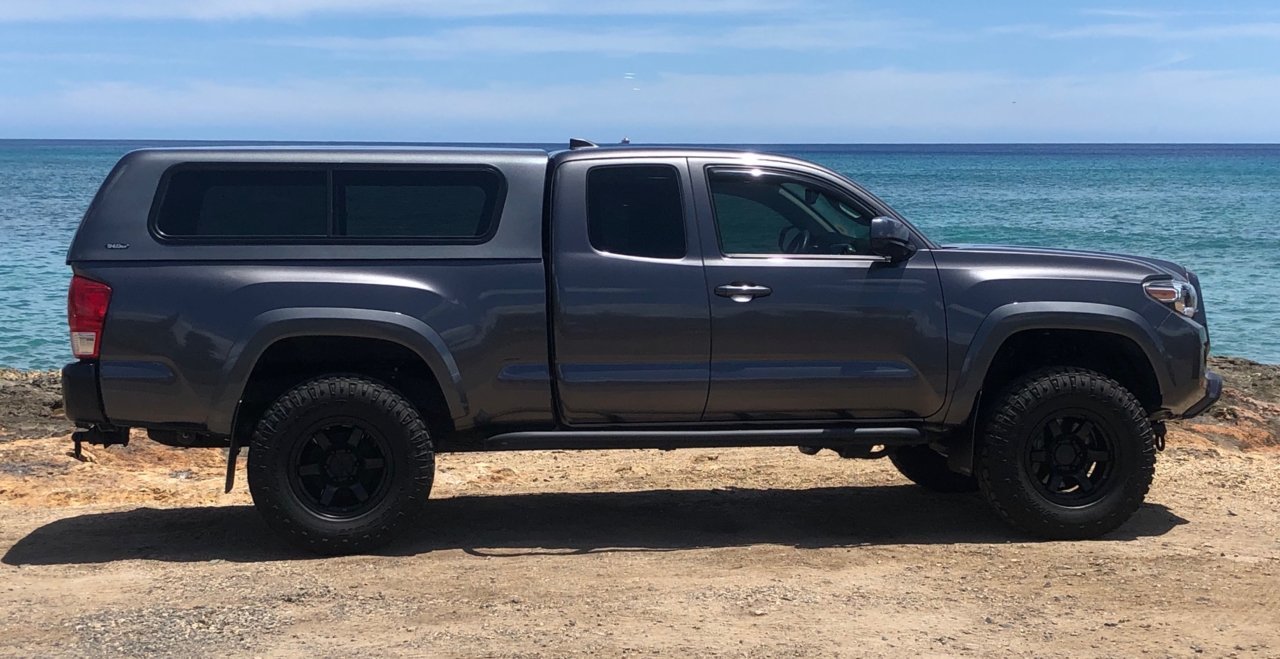

    I have Bilstein 5100's set at 1.55" in the front with a Motofab lean spacer on the left front. The rear has Bilstein 5100's with 1000# Sumo Springs for when I go camping and load up the truck. I had to put in a 1" spacer or the rear would sit slightly lower than the front. I'll probably pull the 1" blocks and change the entire leaf spring set up when the budget allows for it. I just needed to lift it a little to prevent the tires from rubbing when I do go off the main roads so this was enough. I'm presently running 265/75/16 tires with no rubbing. After lift beach 1.jpg
    71tattooguy likes this.

    Were you rubbing with your 265/75/16’s, or was the lift a precautionary effort? Can’t tell from the pic, what rim setup?

    The inside rear portion of the front tires would get close to the inside of the fender well whenever I turned the steering wheel while on uneven ground (about 1/4" from the back of the inner fender) but it wasn't rubbing. I put in the small lift just to give myself a little more clearance and it seems to work fine. On the main roads or more level grounds the stock suspension was more than enough for the 265/75/16 tires. I'm running 16x8 Konig Countersteer Offroad rims.

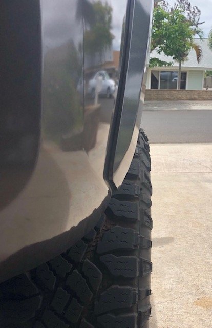

    Front fender tire bulge 1.jpg Yeah the sidewall tread does stick out a little but the main tread area fits under the stock fender flares. A friend has the same set up and tire size as I do but with stock rims and everything fits nicely within the fender. On Oahu you need to have flares that cover any portion of the main tread sticking out from beyond the fender. In my case the sidewall tread doesn't count.
