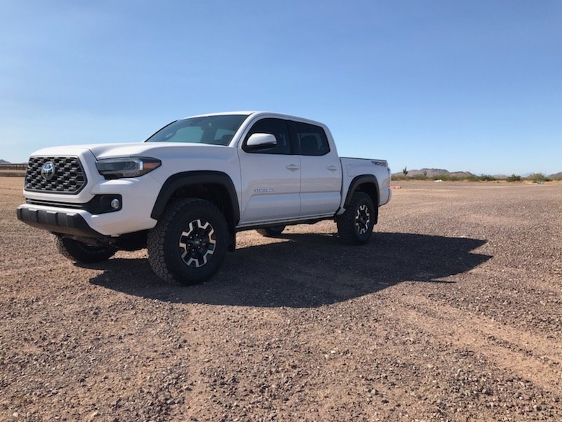

  6. Jun 25, 2020 at 5:37 PM
    #46
    AZmohawk
    AZmohawk Well-Known Member
    May 4, 2020
    #326761
    56
    Dan
    2020 Toyota Tacoma DCSB Off Road
    Bilstein 5100s BFG K02 265/75 R16s
    I kept things on the simple side. I put 265/75R16 K02s on and had Bilstein 5100s installed on all four corners. I had the fronts put on the second clip giving it a slight raise and more of a level look. Between tires and shocks the front came up a little over 1" inch. The back went up the 1/2" inch from the tires. I now have only a 1/2" of Rake which I think looks much better then the factory Rake. There some nice looking Trucks in this Thread!
    Burns, BravoSix and 71tattooguy like this.

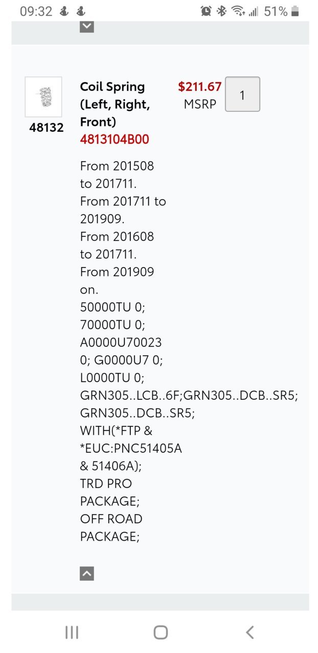

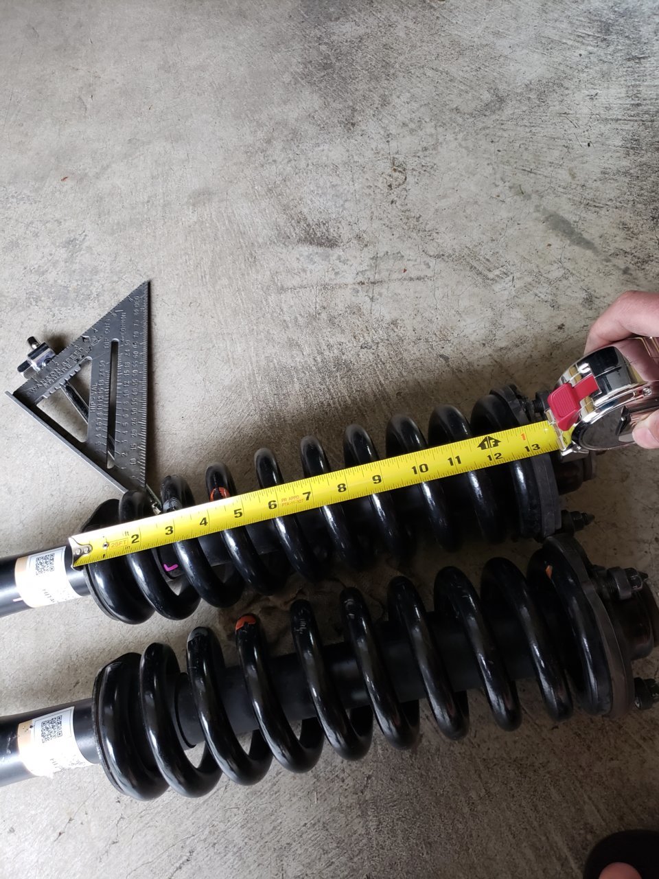

    Not true.
    My OEM coils are exact same measurement-
    13.5" from bottom perch to top plate.
    BravoSix likes this.
  9. Jun 27, 2020 at 5:50 PM
    #49
    jmauvais
    jmauvais Received 2 votes in a poll one time.
    Oct 13, 2016
    #199716
    3,643
    Jason
    NorCal
    2018 TRD OR 4x4 DCSB
    ...stuff
    They are same the same length but the driver side is a heavier spring. Toyota knows the driver side is heavier due to driver, fuel tank, and battery and made the driver side coil spring heavier to accommodate this and keep the truck level.
    If you reuse the oem coils then there is no problem with lean. Aftermarket coils are the same weight on both sides, so that’s when you get lean.
    Claudiomartinof and 71tattooguy like this.

    2017 White SR5 DCSB V6 4x4
    Not according to toyota parts catalog ..
    Same part # for left and right
