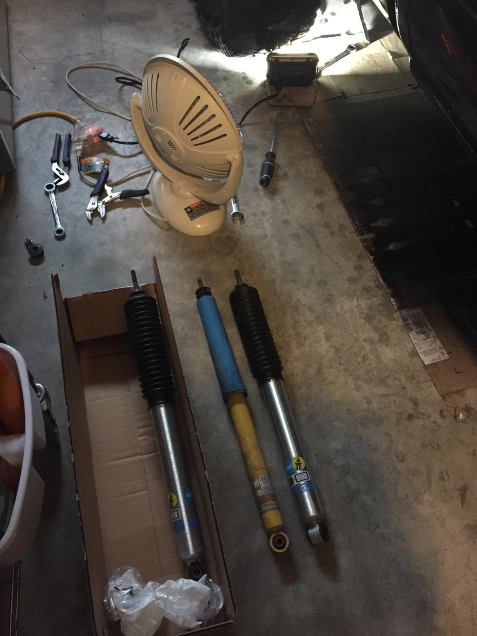

    I put on the 5160 and drove for a week
    Was fine
    Putting the 5100’s in the front with esgs bushing in now
