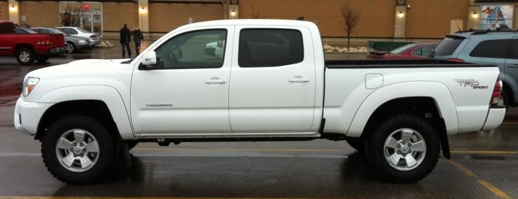

    Yes I reused the stock coils . Here's an after picture

    Looks good!

    Sweet looking truck jermoids ! pretty much exactly what I'm going for .

    thank you!! it's subtle but still looks a little meaner! :)
