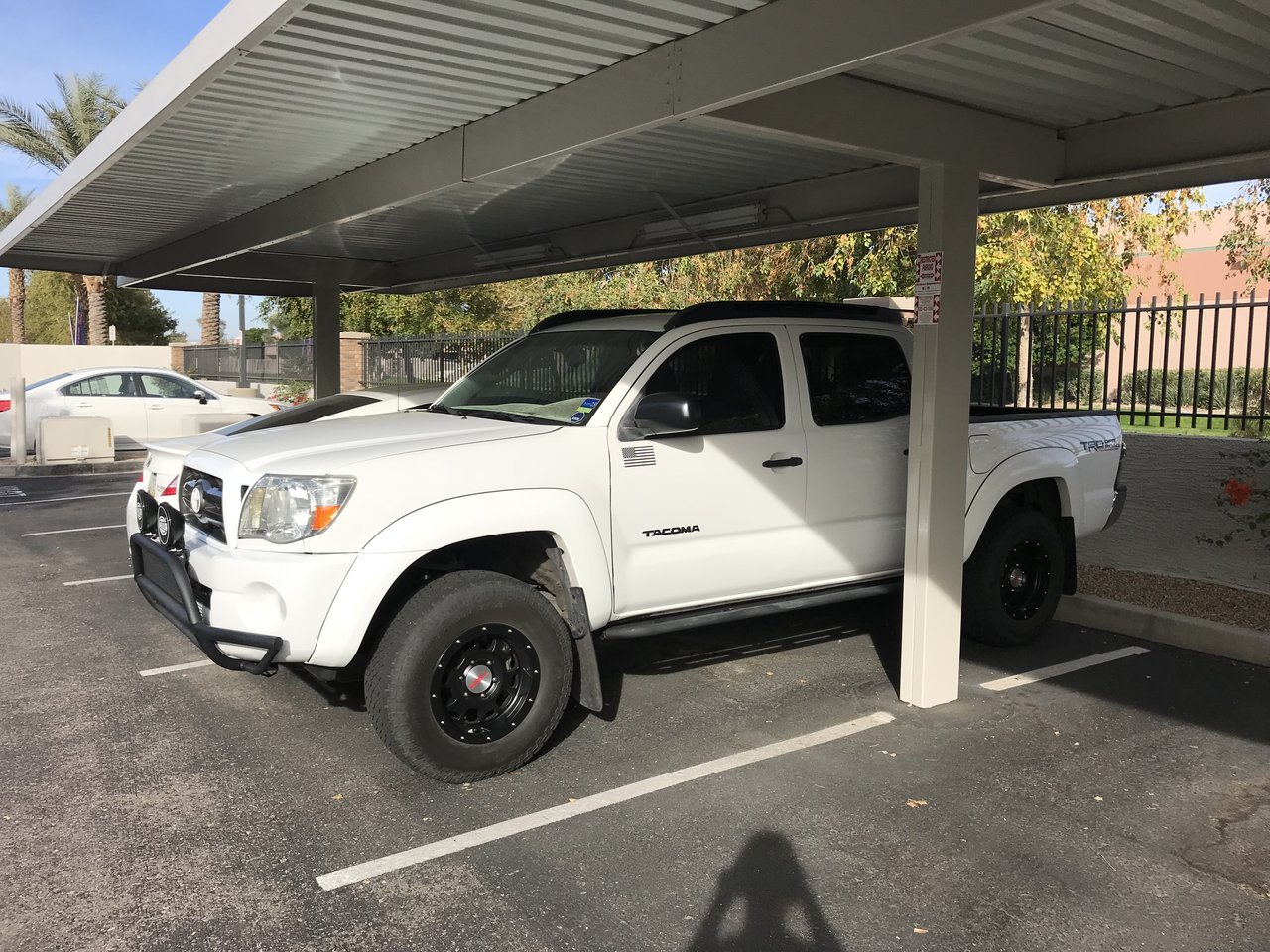

    99kx250
    99kx250 Taco Bell king
    Apr 23, 2016
    #185085
    513
    Joshua
    Arizona
    22 TRDOR
    Deaver+Icon AAL OME 885 springs Bilstein 5100s
    I’ve got Billy’s on my truck front and rear, front at 1.75 setting with stock coils. Levels out the truck and rides super smooth. Just my input :spy:C4C2A0CB-2467-43D1-9ACC-456D54EB1ECE.jpg
    Galves13[OP] likes this.
