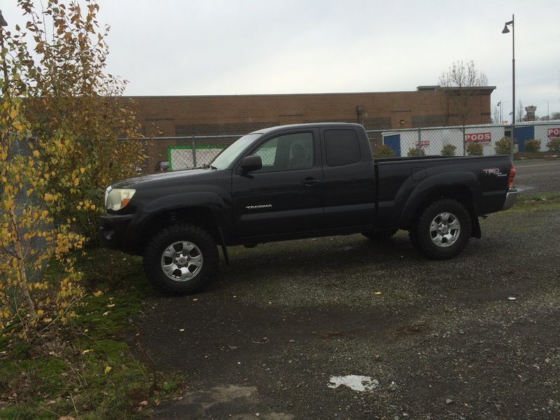

    Alignment problem I'll bet, I noticed the same issue on mine a few years back. it's hard to find a decent alignment shop anymore

    They don't want to bother with caster and camber. They just want to adjust the toe and send you on your way - after taking your money, of course.

    I did pull the tire off, I couldn't see any worn metal parts cause it would take a little to wear the pain off the metal so I took a white paint pen and colored the spots in question. I'm going for a drive then I'll pull the tire back off to see for sure what's rubbing. That's what I afraid of with Toyota but the only off-road shop around can't get me in for 2 weeks and I' have a cross state trip planned for the holidays.

    rub grease or something highly visible on the tire and see where it transfers it to. My concern is that a bent component is not visible. Toyota won't even be able to tell you if a spindle is bent, replacing it and re aligning it would be the only way I think.

    Definitely hitting the UCA, happened to another member on here I know of after putting a lift on his 3rd gen. He had aftermarket UCAs put on as well though and they were able to adjust the alignment in spec at Firestone and it stopped rubbing.
    With a leveling kit you shouldn't need new UCAs but if nothing else works that might be the way to go. Might just be a matter of finding a competent alignment shop though.

    Looking at your pic again closely... it looks like someone did some turning on your tie rod??? Look at the tie rod, you can see wrench marks, also someone tried to mark the setting with black tape??? also look on the inside of the rim, looks like a score mark from rubbing???? Did you install the 5100's or had a shop do it? Also looks like possibly the sway bar was not removed during the 5100 install. Kinda leaning towards possible installer error, in order to not have to remove the sway bar during 5100 install the just unscrewed the whole tie rod end to make room. Hard to tell without more pics. Check all sway bar bolts and nuts, see if there is wrench marks like it had been removed. My guess is possibly the removed tie rod end, tried to mark the threads with black tape in order to know how far to screw it back on, botched the spacing, so tie rod is sticking out to far. Alignment is compensating for the error until the suspention is under load with the weight of people in the truck and driving conditions. So with suspension movement while driving, could cause scoring on the inside of rim and also abnormal up and down motion causing the tire to come in contact with the bump on the spindle :) i know it sounds like JFK magic bullet theory, but evidence is there based on pic :) Get under the truck and identify and take pics of all the bolts/nuts that have wrench marks from 5100 install (if your ok with that) and post them. That would help everyone out trying to help figure this out :) This has me baffled, i'm trying to think outside the box especially since you mentioned you are taking a trip soon... needa make sure its a safe one :)

    I did the install myself, I didn't do anything with the tie rod but I do see in the pic what you're talking about, I did remove the sway bar though. I will pull the tire off again tonight and snap some more pics. And I like the camera idea, I'll have to figure out a way to mount it.

    Have 5100,s on front second highest setting.toyota realignment was done after new frame.tires rub very slightly do to tire deflection.alittle more air may help.Remember cooler temperatures lower air pressure in tires.

    So I took the truck to local (well respected) off road shop and had them take a look. They were told me the tires aren't rubbing which has me a bit baffled since there are marks on the tire. Rey are going to do another alignment and I'll see if that fixes it. I'm now rubbing on both tires.

    I took it to a local off road shop and they did another alignment and the rubbing has stooped from what I can tell. Thanks everyone for all the suggestions and help!
