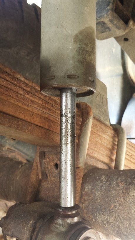

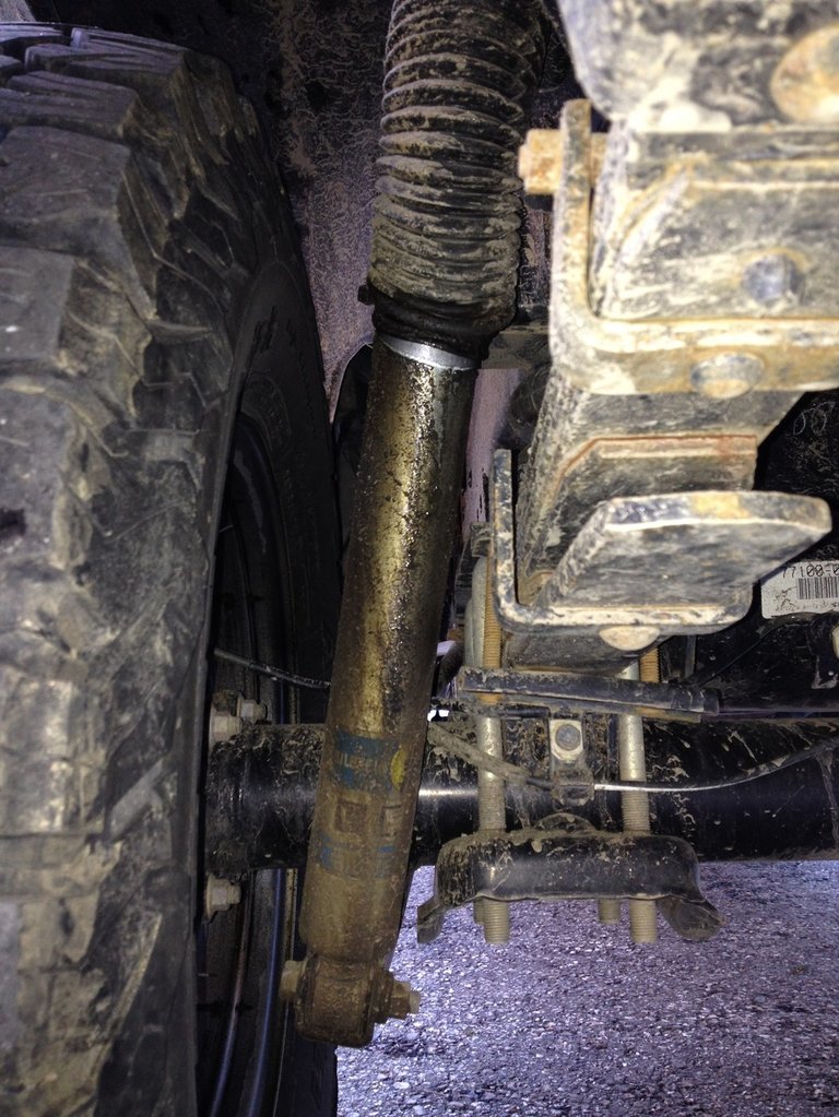

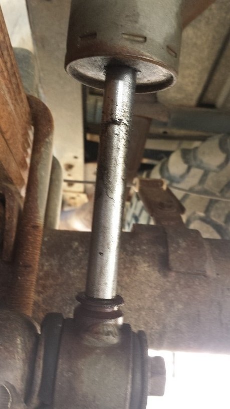

    So, I took my truck in for inspection the other day. Failed because the rear 5100's are leaking fluid, which is grounds for a failed inspection in Maine.
    However, according to Bilstein, fluid seepage from the shocks is considered "normal" and is not grounds from replacement under warranty.
    Part of me is temped to take a can of brake cleaner to the shocks and immediately go for inspection. But, that doesn't solve the real problem at hand.
    Edit: Shocks are 5 months old. 12k miles.
    Here's some pictures of the shocks.
    Driver's side:

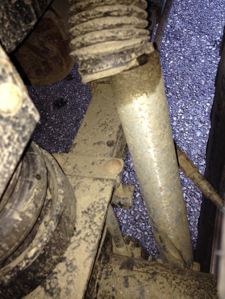

    Passenger side:
    FEC4F835-244B-4356-8A47-C000B2603494_zps_0e58e4b8fab0f62a47987417cba3e4a5aeb07f7c.jpg

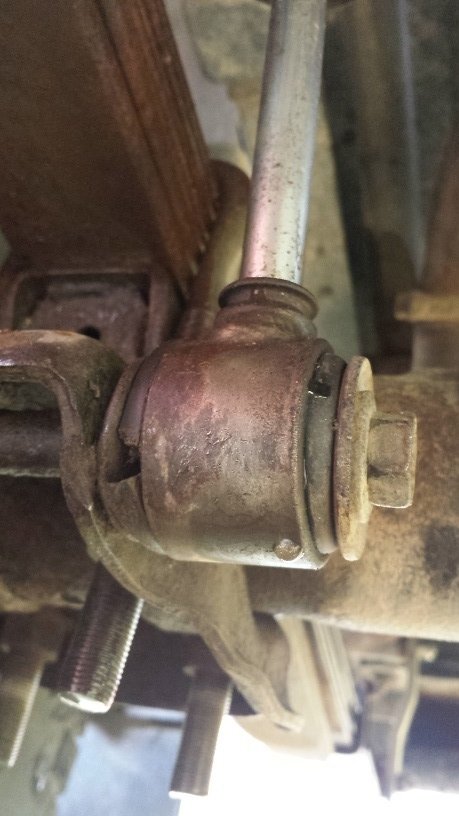

    It goes without saying that I would like some replacement, non-leaking shocks so I can get my truck inspected. However, this is straight from Bilstein's Warrany Page:
    D330E3E0-C8BD-441B-9504-F9789CDED3F5_zps_937a2312d2b673e658109d4c17ff587dea95a987.jpg

    I'll wager the wettest one is blown, the other one 'normal' (not that I like normal)
    That will fall in their 'normal' rating IMHO.
    To the OP, if you clean them up and go to inspection, pass or fail will be based on the savvy of the inspector. IE if I looked at your previous failed inspection and saw rear shocks, I'd know right away you didn't have new ones. So are you going to tell me you just put on some used ones you had lying around?
    Since the one side is pretty clearly done for, I'd recommend ordering up some new ones and just getting it over with.
    It's a shame stuff with a 'big name' doesn't last longer, but I'm curious how many miles / years are on them, and what kinds of loads you may regularly carry.
