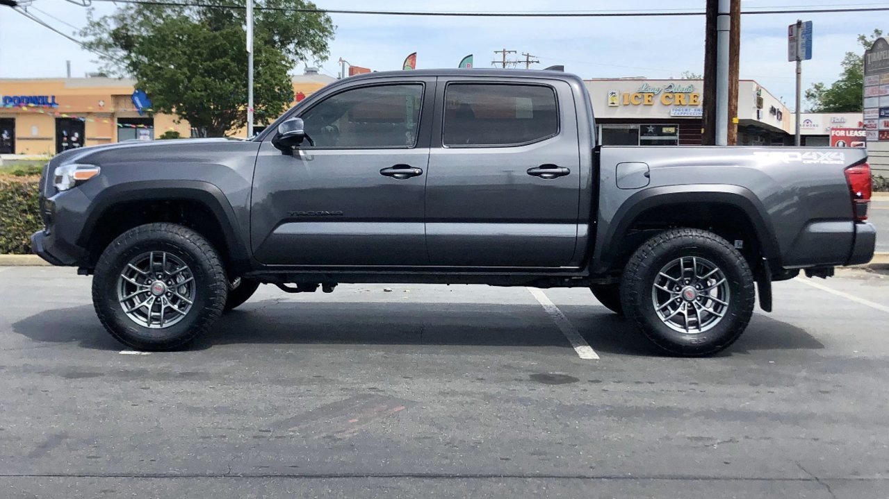

    Bilstein 5100s on 3rd notch with 1/4"lean spacer on drivers side and 1" lift blocks in rear. 265 /75/16 wild peaks.20201122_140331.jpg 20201122_140401.jpg 20201122_140348.jpg

    looks really good !
