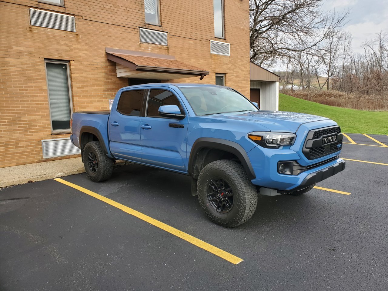

    Looks great. How’s the ride feel compared to your stock suspension?

    I already had the 5100s on for a while set on the 2nd notch with the stock size tires. It stiffens up compared to the stock shocks but in a way I prefer. It no longer leans in turns like it did stock or nose dives when hitting the brakes hard. I don't notice any difference in ride with them set on the 3rd notch compared to the 2nd.

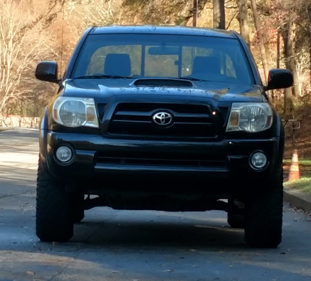

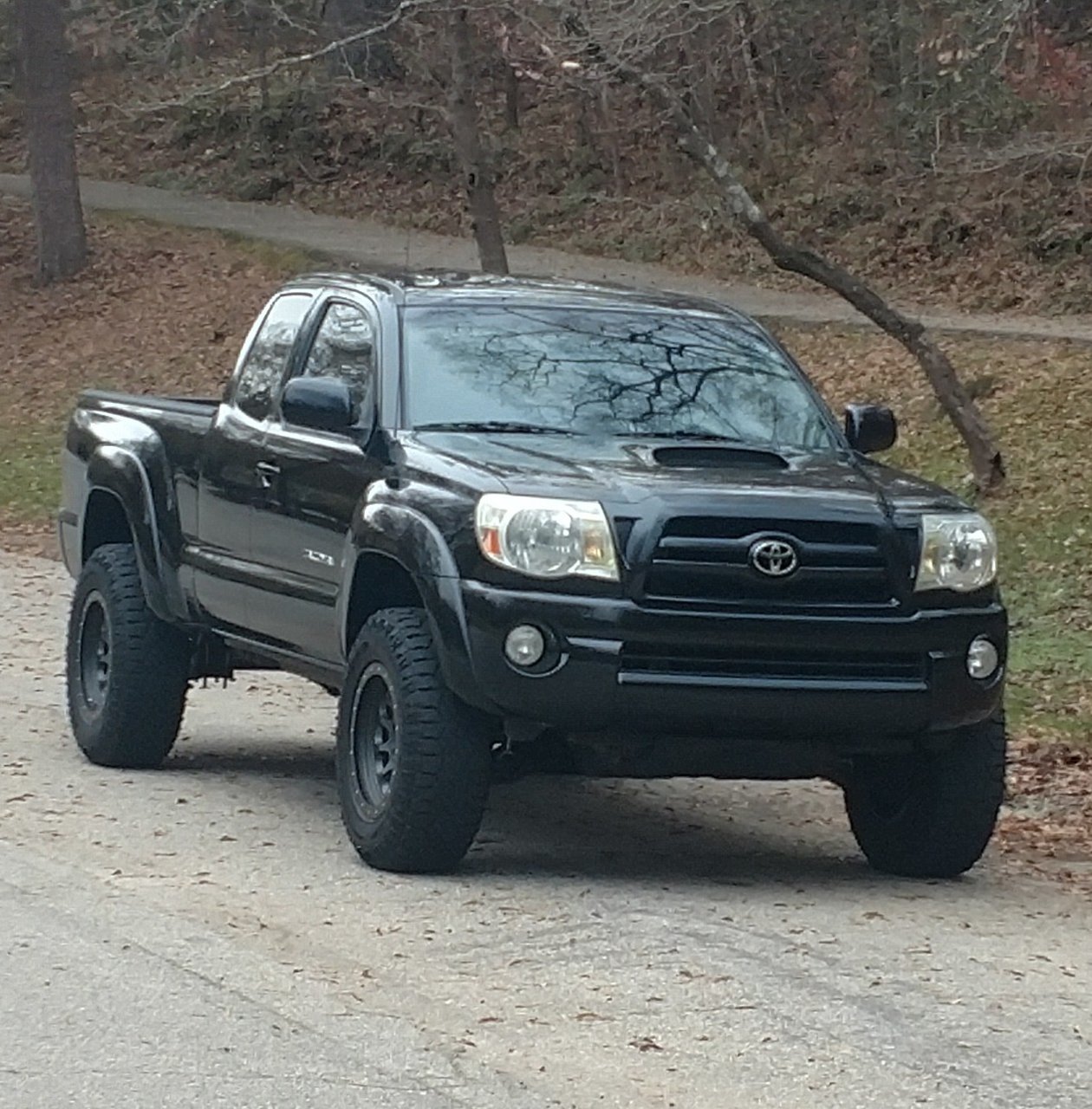

    Bad@Nicknames
    Bad@Nicknames Well-Known Member
    Oct 15, 2018
    #269503
    100
    Bruce
    Greenville SC
    2008 TRD Sport AC
    Bilstein 5100's set at 1.75 Gunmetal Ray 10's
    Perfect follow up question. Thank you.
    DF 20 3/8. PF 20 3/8
    DR 22. PR 217/8
    That gives me 1.625 rake on driver and 1.5 passenger...essentially the same. And that's assuming accuracy in measure. Slightly left or right of plumb from center point of hub makes a difference because of fender curve, and easy to be off an eighth from center point of hub. But I've measured many times and I feel these are fairly accurate. I ordered from Headstrong on Saturday. Going to put Billies at 1.75 and 1inch block in the back. I was just really curious as to if starting point played into advertised result. And how my particular starting point will play into my particular result. Will I get more, less, or equal?
    Really not the end of the world either way. Gonna be fun to see. Also have some Ray 10's sitting in the living room. Haven't changed a thing in 10 years... figured what the heck!

    Bishop84
    Bishop84 Well-Known Member
    Dec 17, 2015
    #172494
    12,055
    You won't
    You won't gain 1.75 from factory, but it will likely give close to that from where it is now.
    I'd say 1.75 is safe and will retain some factory rake. It's good that your truck is sitting level left to right.

    Bad@Nicknames
    Oct 15, 2018
    #269503
    100
    Bruce
    Greenville SC
    2008 TRD Sport AC
    Thanks for feedback! That's what I was thinking as well. I'll post up some measurements when it is done.

    Bad@Nicknames
    Oct 15, 2018
    #269503
    100
    Bruce
    Greenville SC
    2008 TRD Sport AC
    So this dummy took some stuff to a place today. Gonna do 5100's at 1.75 on stock coils. One inch block in the back. Going from original oem sport components. Should be ready on Monday. Will report back with as much relevant information as a dummy is capable of. Peace out...

    Bad@Nicknames
    Oct 15, 2018
    #269503
    100
    Bruce
    Greenville SC
    2008 TRD Sport AC

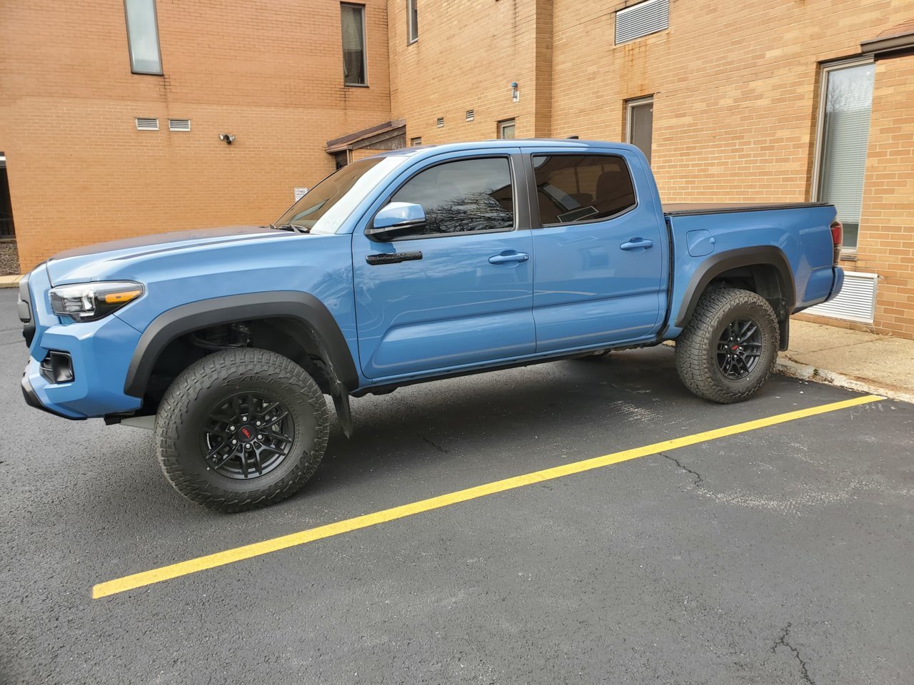

    So just got back from the shop. I haven't done four corner hub to fender measurements but the tech took a fender to floor measurement on their leveled platform and got 1.75 up front which is the setting we selected. My takeoff suspension was the original oem sport components with 151k. I was curious if the age of the takeoff would change the amount of lift advertised to actual. It did not. It drives better. Bumps are much less rough. Only have about 30 minutes behind the wheel so can't offer much else at this point. Overall super happy with the outcome! So far no complaints with the preload or the one inch block.

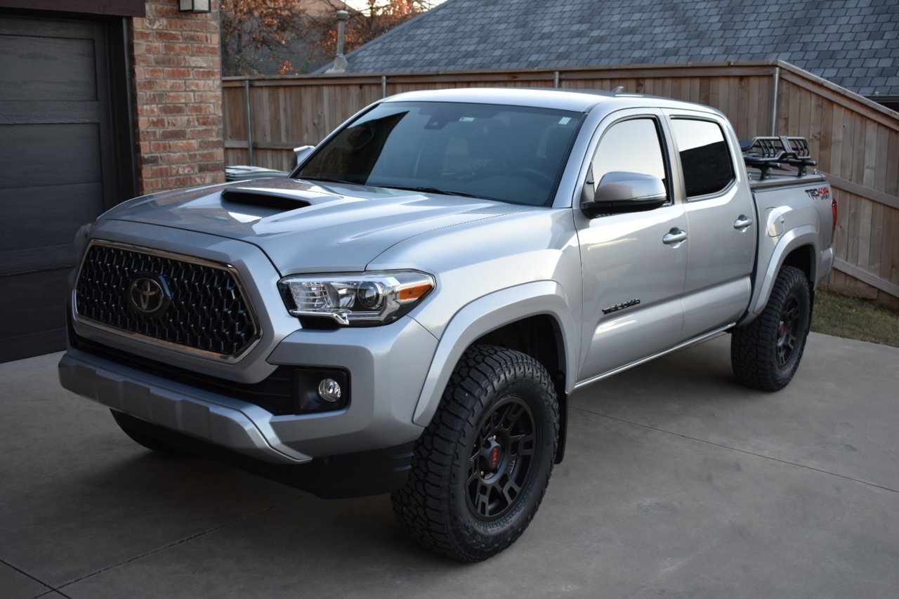

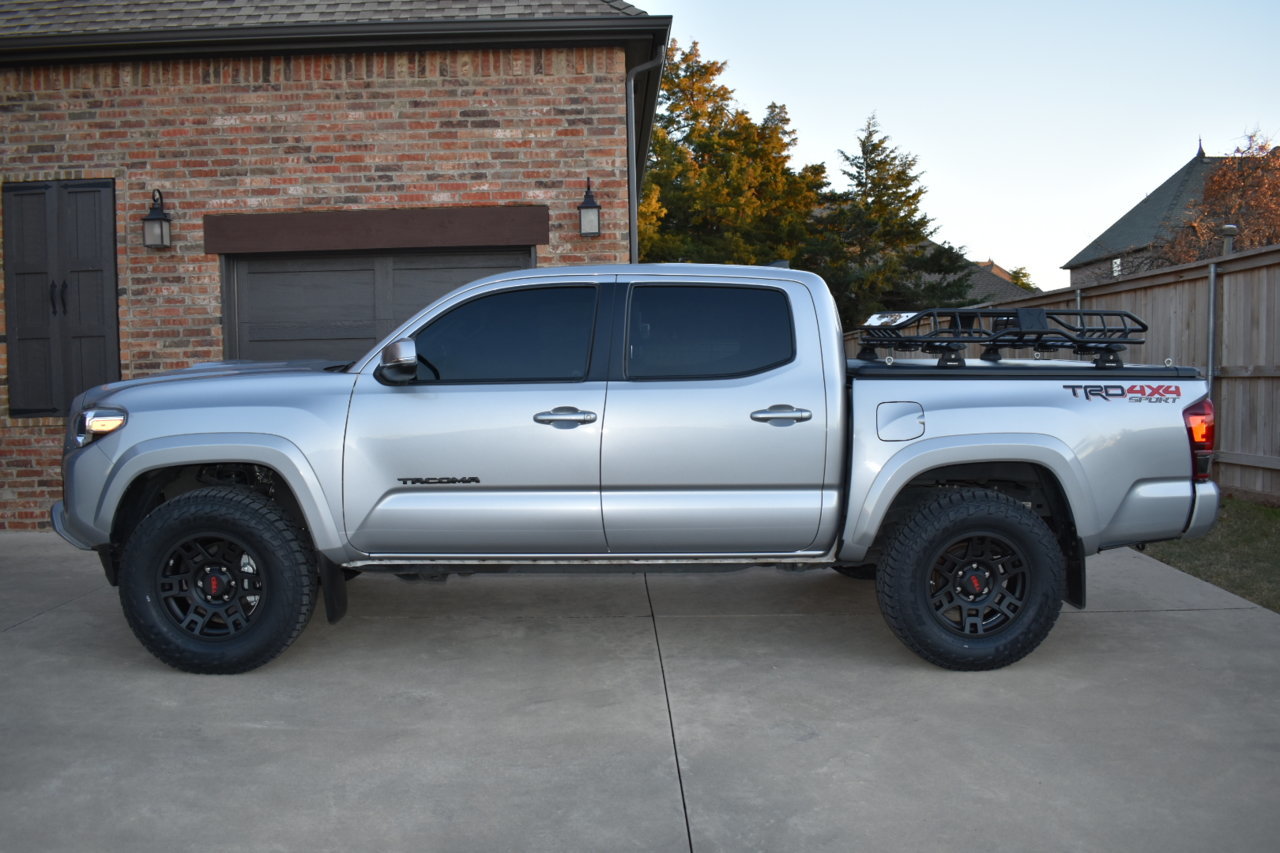

    F97D75CD-1C9C-4485-9A7E-1AE3DB027F6F.jpg 1B46D33A-38E0-4F9E-873E-2978E0C207A0.jpg Okay, so wasn’t really planning on a lift, but I put on new wheels and tires last week (gateway drug?). Bumped up to 265/70R17s and am getting a little rub in the front, and the tires just look a little large in the wells at this height IMO. Guessing 5100s could help solve both of these concerns (and improve the ride based on this thread), but I know nothing about lifts.
    Not looking for anything dramatic height wise...just want a little more clearance and capability (for occasional off-road use). Also, would want to maintain factory rake. So what would be a recommended setup? What’s the deciding factor/s for adding a block vs adding a leaf in the rear?
