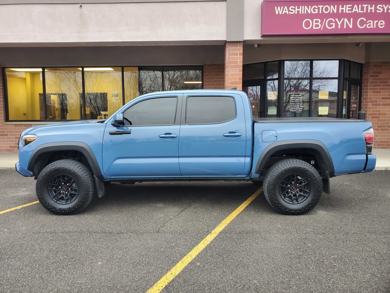

    2019 Tacoma TRD Off Road Premium Cavalry Blue

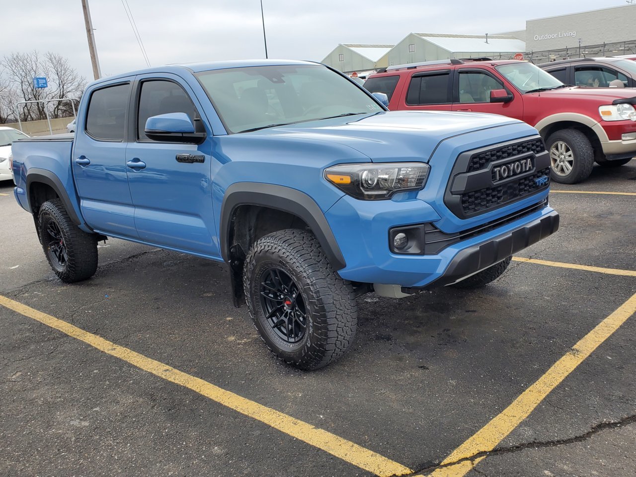

    A few.
    20201213_141658.jpg 20201209_111647.jpg 20201209_111740.jpg 20201209_111707.jpg
    rblalliance, Burns, TacoCPA and 3 others like this.

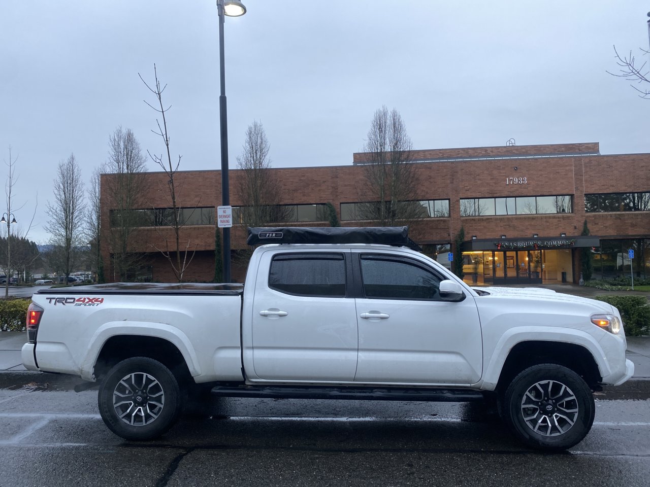

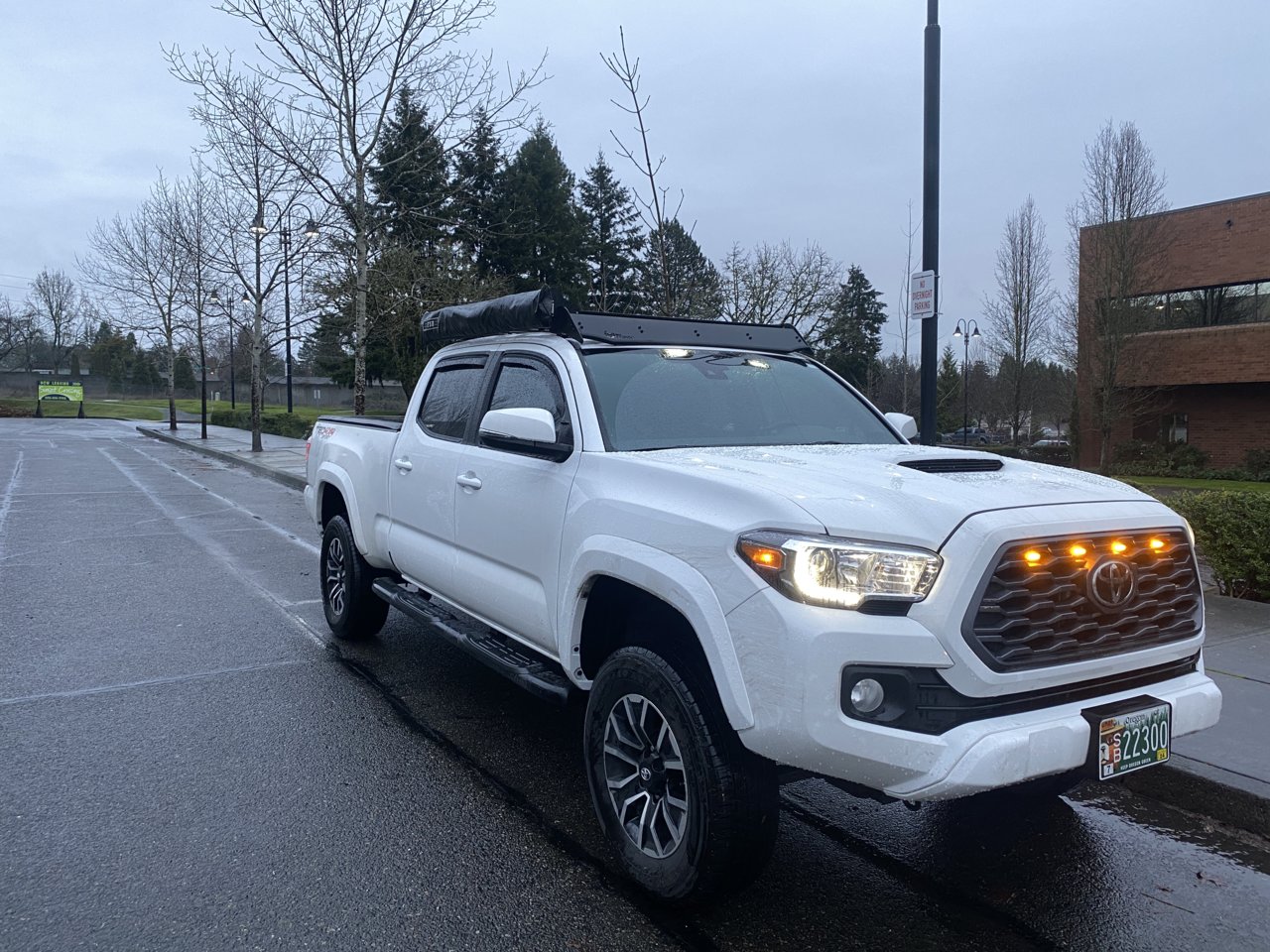

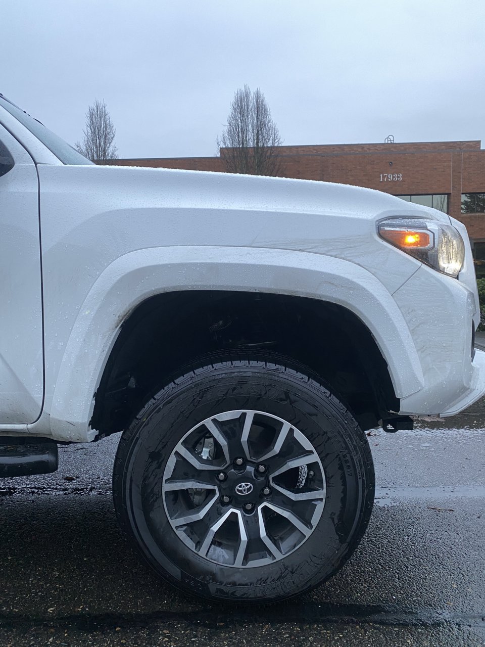

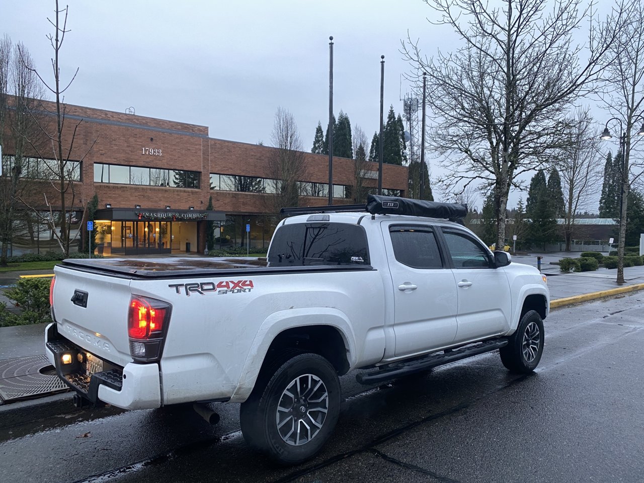

    I just installed the 5100's front and rear with a 1" block in the rear last night. Stock coils, stock tires, and wheels. I do like the ride more compared to the stock suspension. I have a set of Falken Wildpeak at3w 275/70R17 sitting in my garage ready to be installed. Just waiting for my wheels to arrive.
    Here are some pics with the lift on the 4th setting
    2015TRDOR, Burns, hillkyle14 and 3 others like this.

    Looks great
  19. Dec 20, 2020 at 4:41 PM
