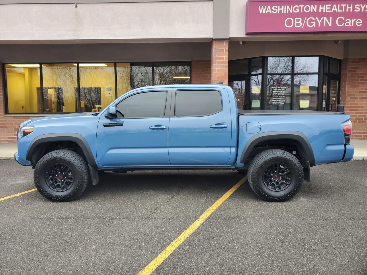

    Go 1.1 setting

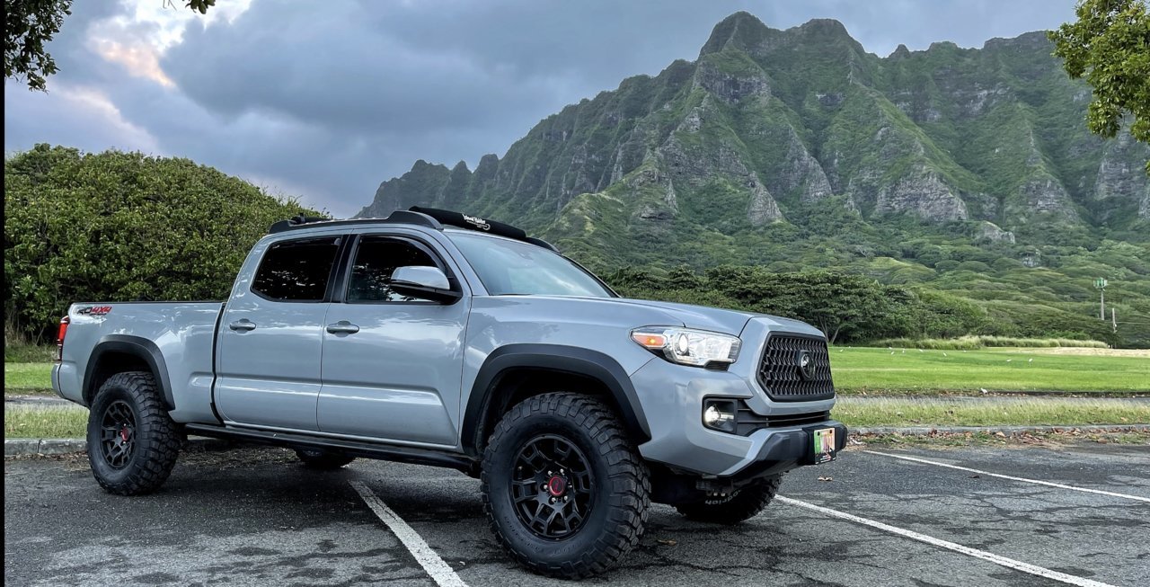

    808Raider
    808Raider Well-Known Member
    Nov 22, 2009
    #26356
    202
    hawai'i
    i just got a dc lb trd or 4x4 and my front measures 35-35.25 and my rear about 37. I should do 3rd (1.1) or 4th perch (1.55)? I was originally thinking 3rd bc i have a bigger gap than expected. unless the rear settles or something but I also don;t want new ucas diff drop and all that extra stuff so tempted to play it safe on the 3rd perch.

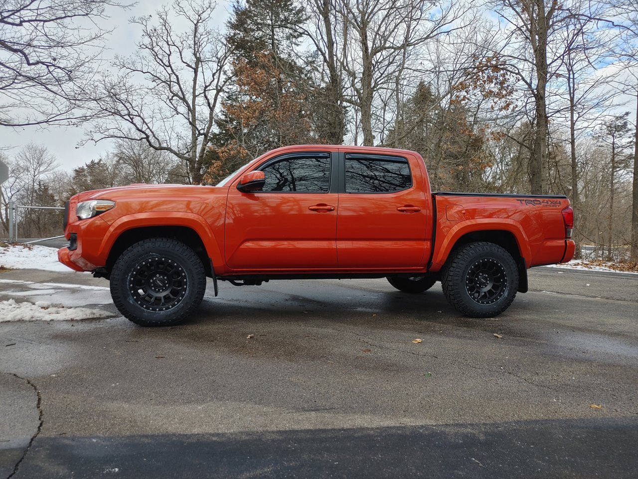

    If u put it on the 4th notch it will be nose high without something lifting the rear. This is mine on the 3rd notch with 1 inch rear blocks.

    excuse my ignorance, but if my rear is 37 inches high and my front is 35 inches high, how would i be nose high at 4th perch that raises it only 1.55 when the difference is 2 inches? everything i read up said the rake is an inch on average, so yes I would be nose high if I was avergae, but I am at 2 inches instead. i don't really haul heavy stuff either except for surfboards and coolers when camping and hunting. so keeping a little rake isn't a huge priority

    thx but that'd put my front at 36.5 and rear at 38 if going off my current height. same rake just higher up. not trying to put on bigger tires just get level without any other shenanigans

    didnt make a difference. still about a 1.75-2 inch difference. guess i wont need a block in the back then
