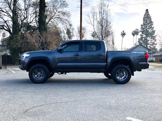

    What size tires are you running in this photo?

    265/65/17

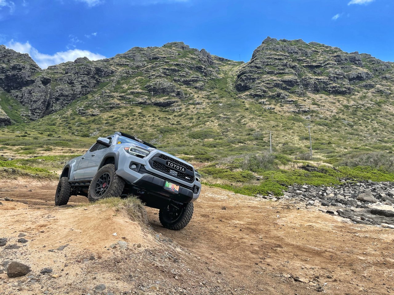

    E97C0524-8110-4131-90D0-F00FA819B64E.jpg 5100s top notch rear add a leaf and 33s stupid capable. Full skids so no stress just waiting on my sso front bumper to come in
