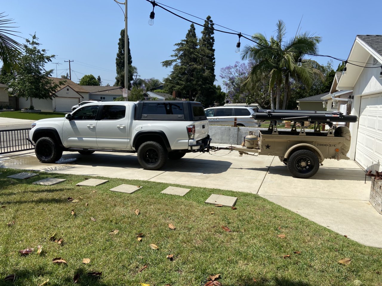

    Had mine on 3 with airbags. Went to 4 and installed Deaver 402 Stage 1. Perfect for my applications. Good thread!

    Did you remove the airbags when you went to 4 with the Deaver Stage 1?
    What are your applications? How much weight do you have added? This sounds close to what I am considering but I was looing at the stage 2 Deaver which is supposed to be for consistent added weight of 400-600 pounds.

    Yes I removed the airbags in fact there in my garage. Soon to be thrown up on craigslist. I have an RSI smartcap and usually it's just my dogs and some items in the bed. If I go on an expedition I throw some Plano's and my coolers in the back but never to exceed 300 pounds. All my other stuff is in a jeep trailer which I tow behind. It's a military M100 trailer with a roof nest mount it on top.
