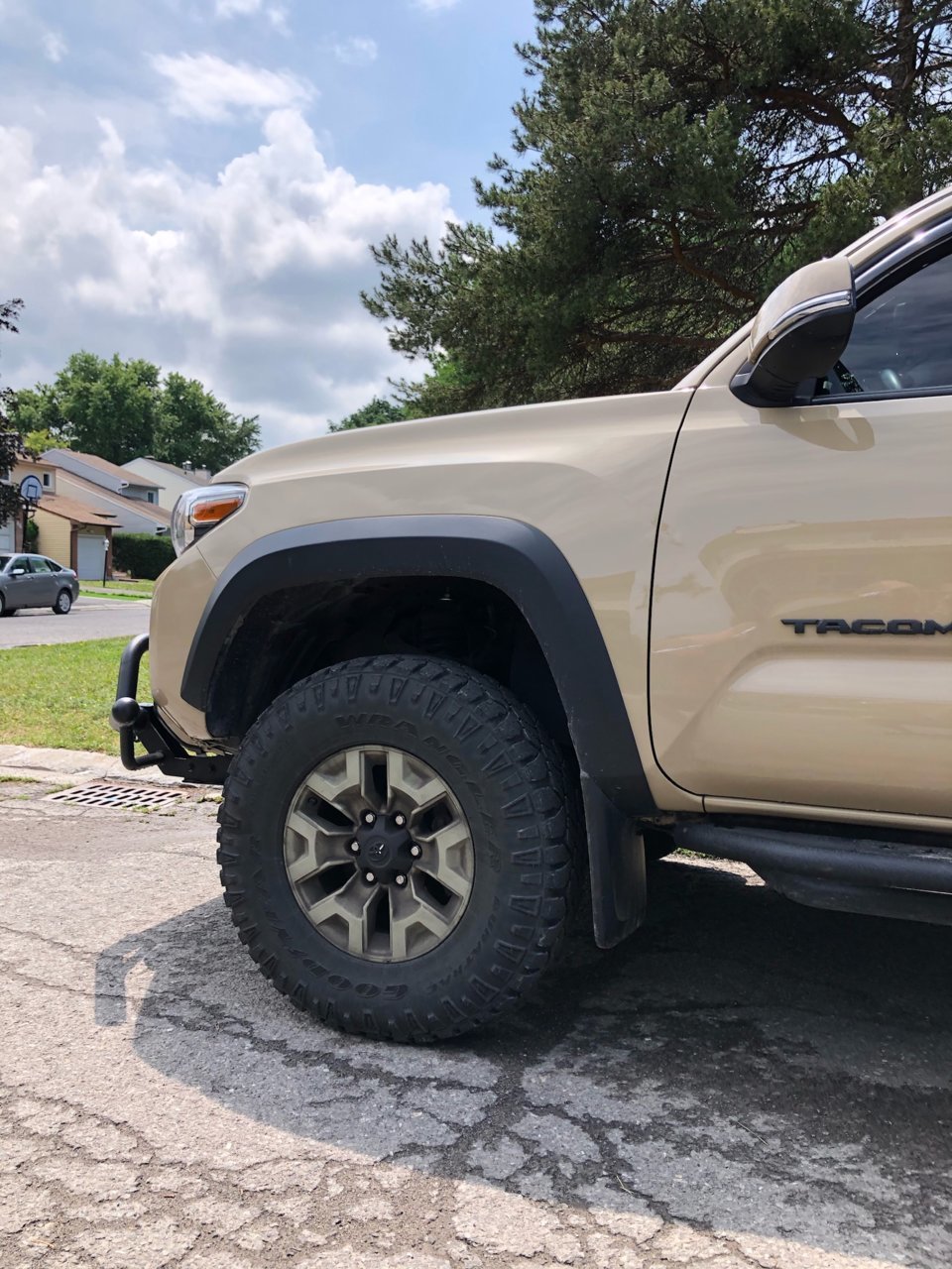

    I set my 5100's up front to 2" with the stock coils (as recommended by Bilstein). Naturally it sits higher in the front right now.
    I'm going to ad 1" lift in the rear, and this will level the Taco, as it now sits 37" in front and 36" in the rear. Regardless, the ride is great, but like you, I want a level look, but without the slight forward rake that you are looking for.
    I'm guessing if you set your front @ 1.1" and ad that 1/2" rear spacer you will get that slight rake, or perfectly level without the spacer. Personally, I wouldn't ad the 1/2" spacer, but that's just me.

    Looks great. What’s size tires you running on the stock wheels?
