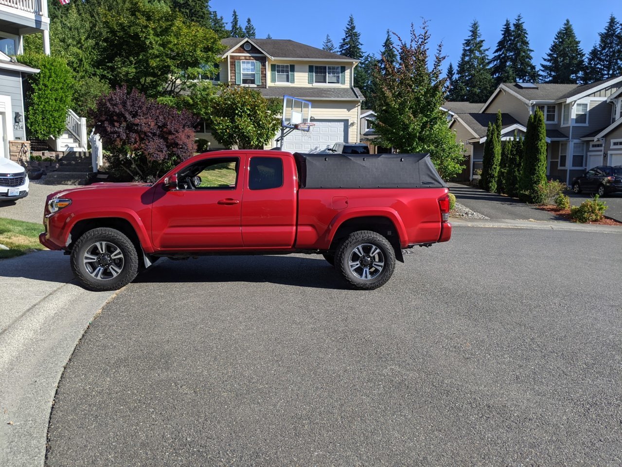

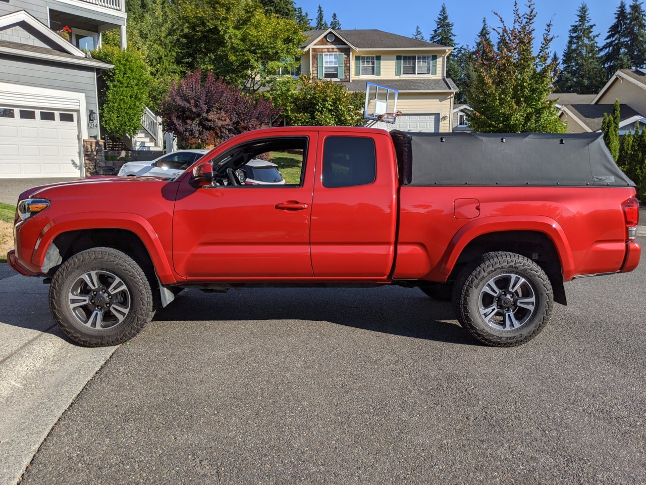

    Before a road trip, I got the fronts installed. 4th clip position on the left and 3rd on the right. Perfect 1.5in of rake and just a hair of anti-Taco Lean when no one is onboard.
    Check after fronts with 3/4 tank and new front body mounts:
    LF: 22 1/8in RF: 21 7/8in
    LR: 23 5/8in RR: 23 1/4in
    Handled like a champ on the first half of the trip. Feels great.
    71tattooguy and bboyh5 like this.
