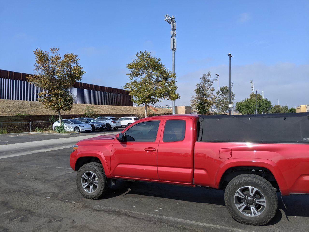

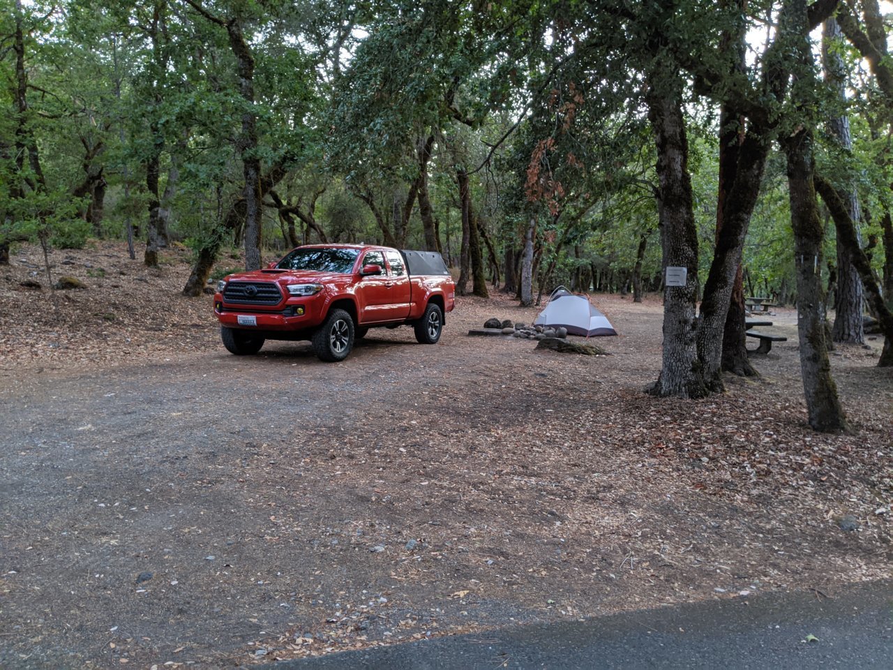

    I'm at Option 1. I wanted to stay near stock height with about 200lb of permanent weight in the bed. Option 1 put me up 1.5in over stock, so I did the same up front and have 1.5in of rake.
    I didn't measure loaded, but it appeared to have some rake when loaded. Lemme see if I grabbed any pics.
    I did 5100s. I'm waiting on the rears (thanks, COVID). Up front I went with the 4th clip location on the left and 3rd on the right to cancel the lean. I have measurements posted earlier in this thread.
    BTW, I was more or less level on the stock suspension with just a Softopper, bed mat, and recovery gear back there. About 200lb, as noted above.

    So this picture is with the 1,000 pounds in the bed?
  18. Aug 19, 2021 at 11:18 AM
    #458
    tonered
    tonered bartheloni
    Sep 25, 2017
    #231055
    31,281
    tony
    Lynnwood, WA
    Yes. Both pics. The bed plus the rear of the cab. Packed to the gills.
    It was estimated. I wish I got a real weight.

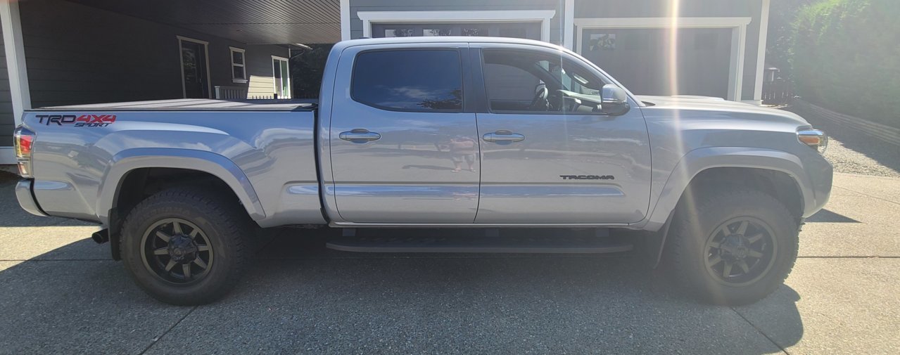

    Prinsu roof rack with 42" light bar Caliraised ditch lights Caliraised Bolt On 0 degree sliders with kick out Anytime front/backup camera from runnin4tacos Caliraised front hidden bumper light bar KDMAX Pro-XT Tune (Normal Throttle) TC Cam Gussets TRD Pro Skid RCI Transmission Skids with Cat Protection Suspension: Bilsteins 5100 all around with 1/4" spacer on driver side set at max setting with stock coils, wheelers AAL 1.5", ECGS bushing replacement Tires: 265/75/r16 Toyo AT3s Wheels: Method 305 NVs Bronze
    Before and after: 5100s all around with fronts set at max setting for 2" and a 1/4 inch spacer on the driver side. Rears with wheeler's AAL for 1.5". Stock coils, stock wheels and stock tires (265/70/r16). Only add-ons I have are caliraised sliders.
    So far, I think it's great and I'm pretty happy with it. I don't feel any harshness, but I did just pick it back up. May update after a week or so of driving and see if there will be any settling.
    Measurements before and after lift:
    DF: 20...........22 1/2
    DR: 21 3/4.....23 1/2
    PF: 20 1/4......22 1/2
    PR: 22...........23 1/2
    Looks like the 5100s gave 2.25" of lift on initial install. I may have rounded for my DR measurement after... but overall I maintained a 1" rake. Looks pretty dang good to me.
