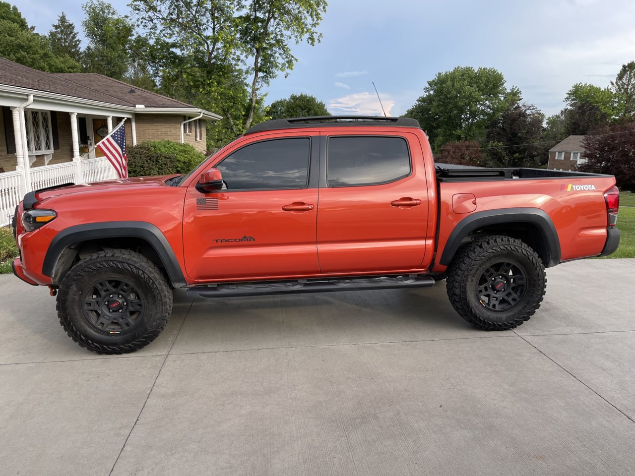

    Looks good! Now all you have to do is wait for you tires to wear out and go to 275/70/16s. That'll give you a bit more still. Keep a feel out for the needle bearing vibration. You may be one of the lucky ones tho.

    Oh yeah I did the ECGS replacement at the same time! Forgot to mention that :)
    That's the plan! Upgrade the tires when they wear. Guess that just means I gotta get the truck out more!
