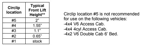

    Has anyone put Bilstein 5100s at the second setting (0.65”) in front and left the back stock? I’m thinking of doing that so I can have a bit more height in the back in case I want to load the bed. I’d be concerned the 3rd setting would be too high and second setting would give a better ride.

    I’m considering the second setting (.65”) for mine. You think it would be that much of a difference from the 3rd setting (1.1”)? I noticed you were on the fence between the 2 settings in your OP.

    I’m thinking the second setting might be best. Only adds .65” so you have some room to weigh down the back without it looking bogged down. Better than no lift at all in front. I’ve also heard that the less you lift these Bilsteins, the better the ride.

    I had mine on the 2nd setting in front with stock height in back for a while. Havent noticed a difference in ride going to the 3rd notch. Rear was slightly higher when on the 2nd notch

    Thanks. Did the second notch make a difference visually? My front is only about 1” lower than the rear, so I’d prefer to use notch 2 vs 3.

    Ya it did. I tried it on the 3rd notch at first but it felt nose high when sitting behind the wheel driving it even though it measured level. We have to keep in mind that when the truck is put in gear and driven down the road, the driveline torque causes the rear to go down slightly so a truck that is perfectly level when parked, can look nose high when going the the road.

    Good points. That’s why I’m thinking about setting 2 (.65”). Also, there are a few threads on TW that suggest a front lift of 1+” can lead to premature needle bearing wear.
