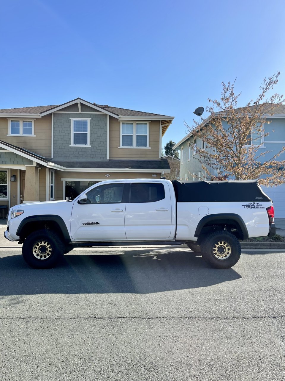

    Nice! 2 Questions:
    • Did you need to do new UCAs in front?
    • Did you need to extend brake line in rear?
    Stress on the "need to do" vs. "did it cause I wanted to".
    EDIT - and what size tires you running?

    Yes on UCA’s and yes extended brake lines. I definitely would will ease your mind. Tires or 16x8 265/75/16 maybe I will go up to a 255 but super stoked on set up.
    Thank you bro appreciate it :thumbsup:

    Since this pic went with 6112’s and full
    Leaf pack. Rear is Deaver aal in this pic. Yes on the clamshell and diff drop. And thank you :thumbsup:

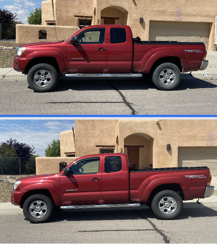

    Just got my setup with my Bilstein 5100s on all four corners. Set at number 3 in the front with no blocks nor leafs added to the rear. Also, I left the stock UCAs on and didn’t install a diff drop. Love the ride, especially driving at a pretty good clip along a power line road here ridden with rocks, sands, steep dips and trenches in the southern New Mexico desert! And she still rides smooth as butter on the interstate going 75 mph tracking straight as an arrow. CFF35DEC-EB00-4E7A-9332-A96460826AAE.jpg

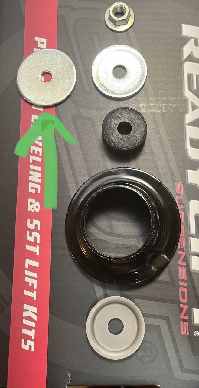

    Can anyone tell me what this giant washer is for? It’s not part of the instructions and doesn’t even fit over the threads anyway.

    Bumping it up to see if anyone can answer this? Thanks.

    I believe that is the shim for the bump stops. See the attached instructions.
    I didn't use it myself.
