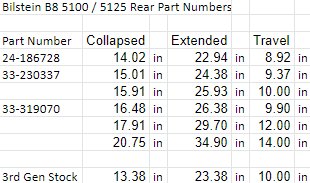

    You're lifting the rear. So, when flexed at full travel, the 5100s will limit it. The extended travel 5125s will give you more droop. If you have the right bump stops to support the longer 5125 part number, it could be that the leafs are the limitation of travel.
    For the longer 5125 part number, you'll want to verify that the main and parking brake lines are good for that much droop also.
    This is the info that I have:
    Also note that the sleeved that comes with the 33-230337s needs to be cut down to fit the lower mount on the axle. That's the part number that I have. I don't know what the situation is with the other part number. Likely the same.

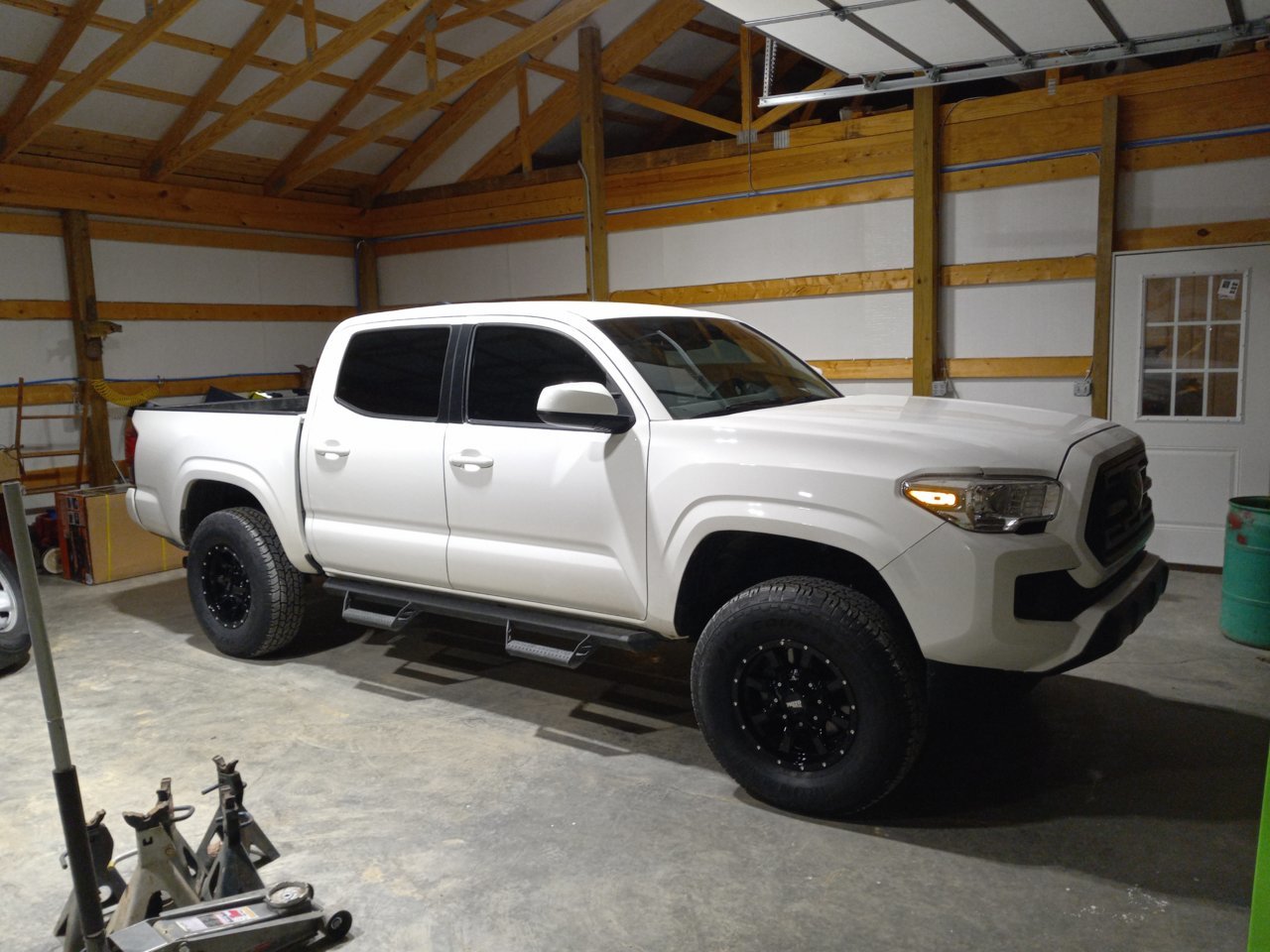

    5100s all the way around. Set at #3 on front. 265-75-16 all added today. From the floor to bottom of fender 37" on all 4.20221216_175603.jpg

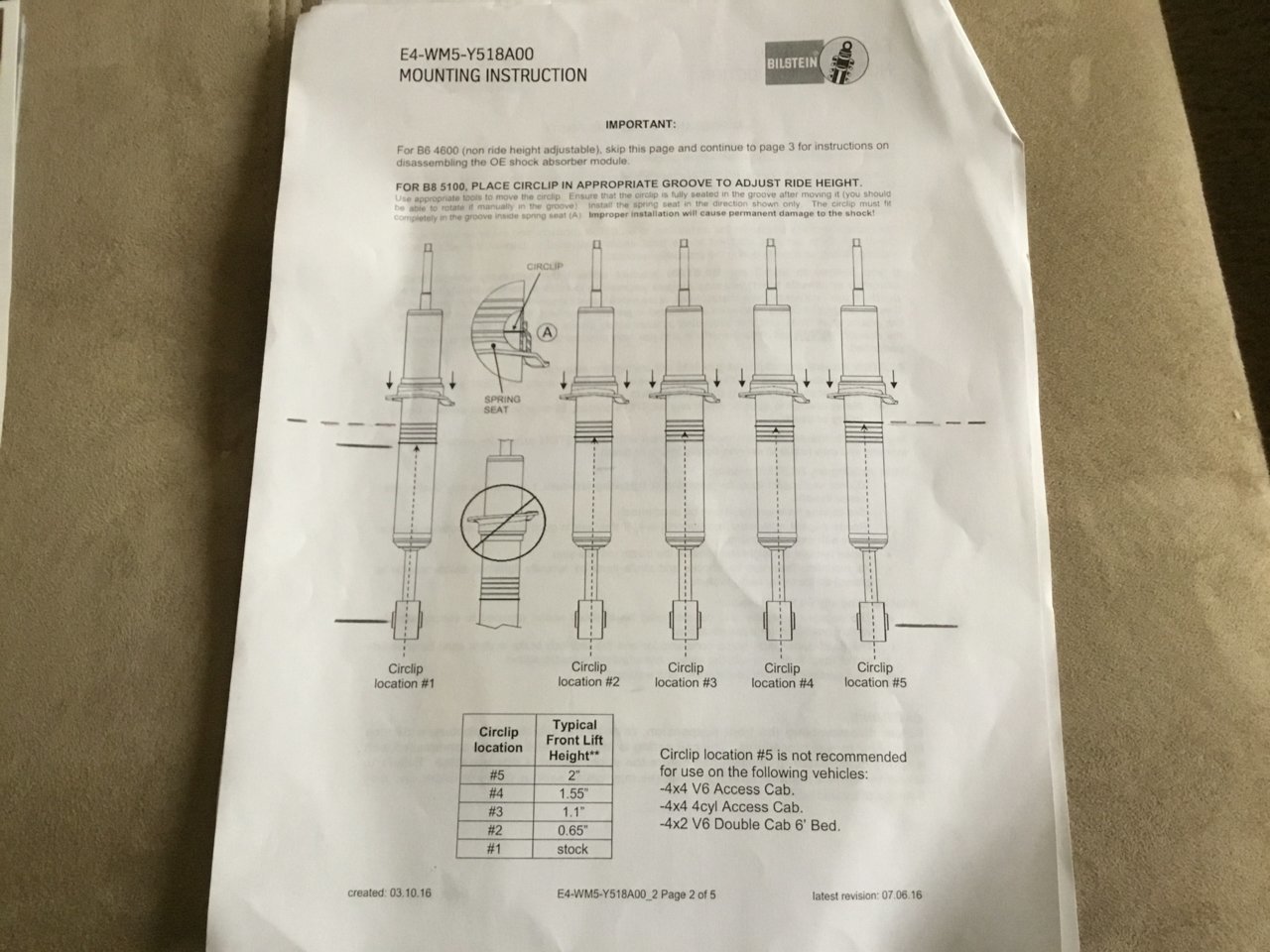

    Okay boys, based off of this I was going to do clip 5 on drivers side and clip 4 on passengers in hopes of getting 1-1.5” of lift with no taco lean.
    thoughts?

    It says not to use 5th clip on 4x4 access cab.
