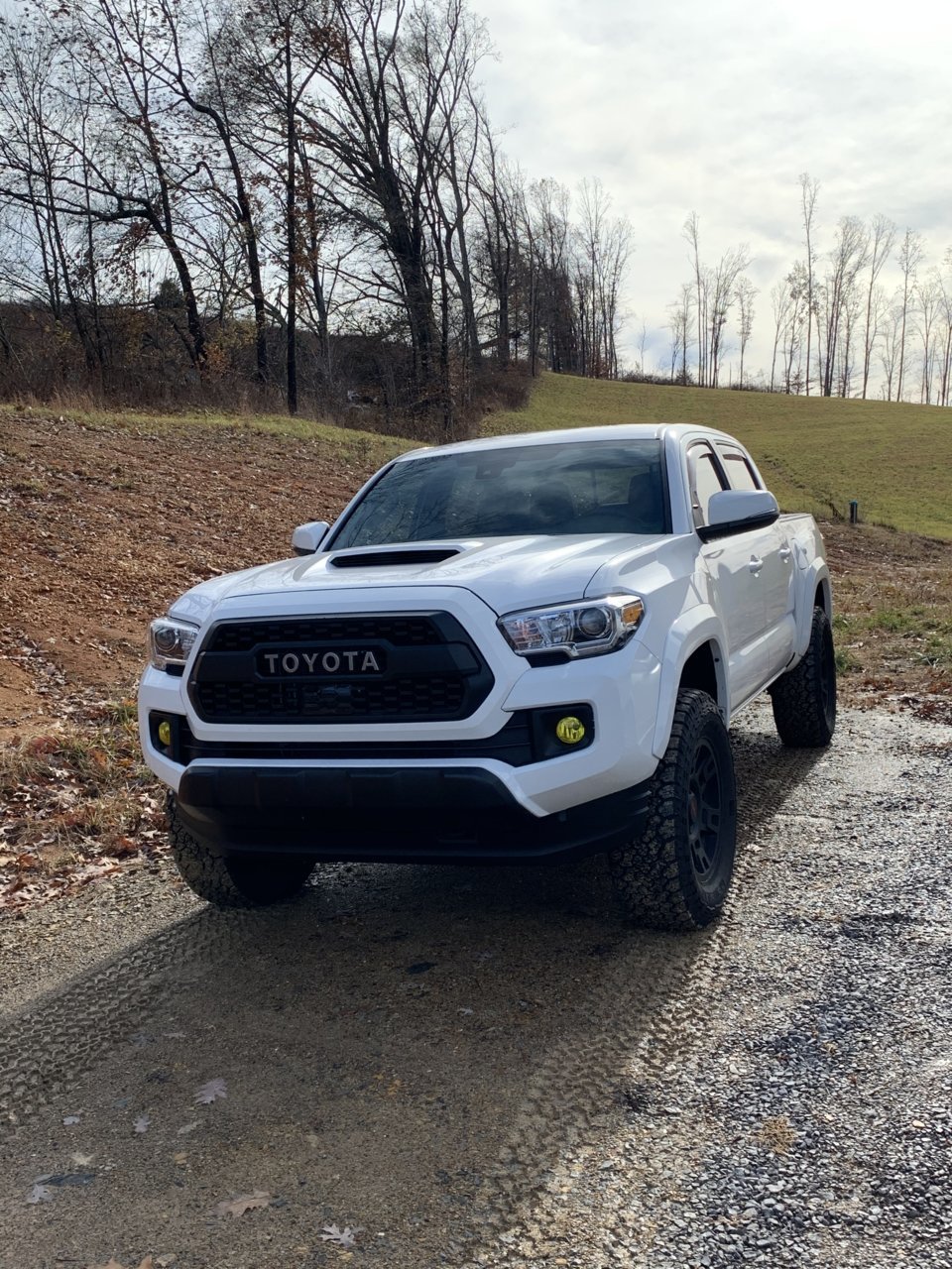

    Rides and handles slightly better than my stock sport suspension. Nothing game changing but definitely seems to corner a little better. Not harsh at all like I’ve seen some say on here in the past.

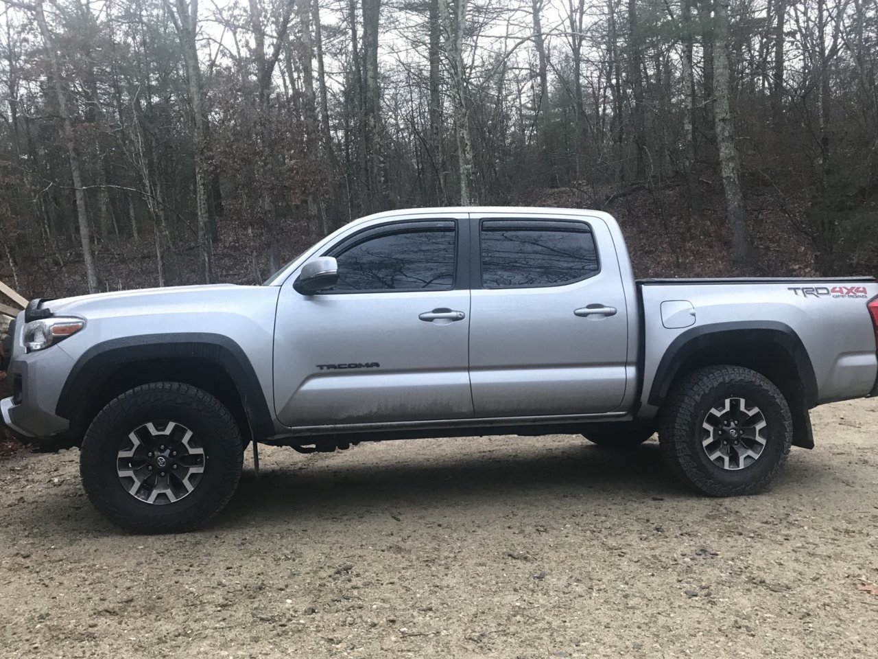

    ‘17 OR with 5100s all around, front on middle setting with 265/75-16 Wildpeak AT3S 7A8BD8B8-AD47-4A87-87B1-95A2D8865961.jpg

    I’m parked on an incline, notice the trees in the background. It’s pretty dead on level on level ground. Rather have a flat driveway.

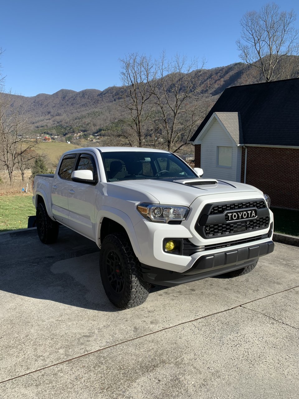

    Are those 265/75/16's?

    Yup! Dick Cepek EXP
