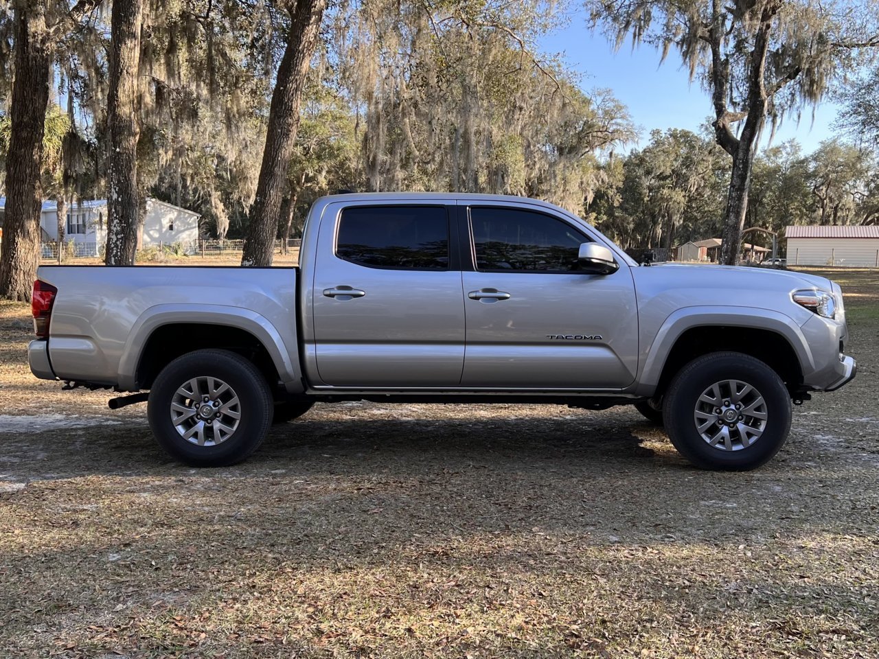

    Just put 5100's on the front (3rd clip setting) with 1/4" driver lean spacer, sitting level on all 4 corners
