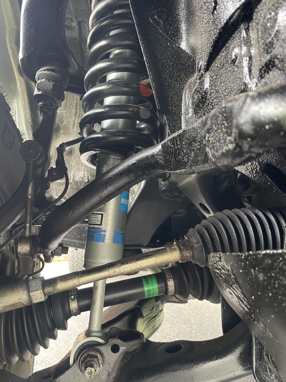

    curious how long should it take to install 5100s on front using no spring compressor method. truck is 16 with 110k on it so pretreat bolts today for possible tomm install. half a day?? usually pretty handy on stuff. then next wk install new icon rxt leafs and 5125s.

    if you do this in your driveway by yourself I would say 4 hours taking your time. And then 2 more hours to add a block on the rear… one full day from start to finish I would say…

    ok, need some help. damn flat spot on top nut broke off so cant loosen bolt. i figured i just take off as whole strut/spring assembly. well, when loosening swaybar endlink the allen side stripped halfway. so now it wont come off and i cant tighten it again. any ideas, ill prob order new endlinks but what do i do in meantime.

    Guess I can drive without endlinks for now. I can just cut top nut off then lower lca to release pressure on spring then remove. Correct?

    No. You cannot drive with the swaybar end links removed. The sway bar ends will murder your CVs.
    I haven't had the sway bar on for like 80k though. Don't miss it, and I still rally corners. That's just me though.

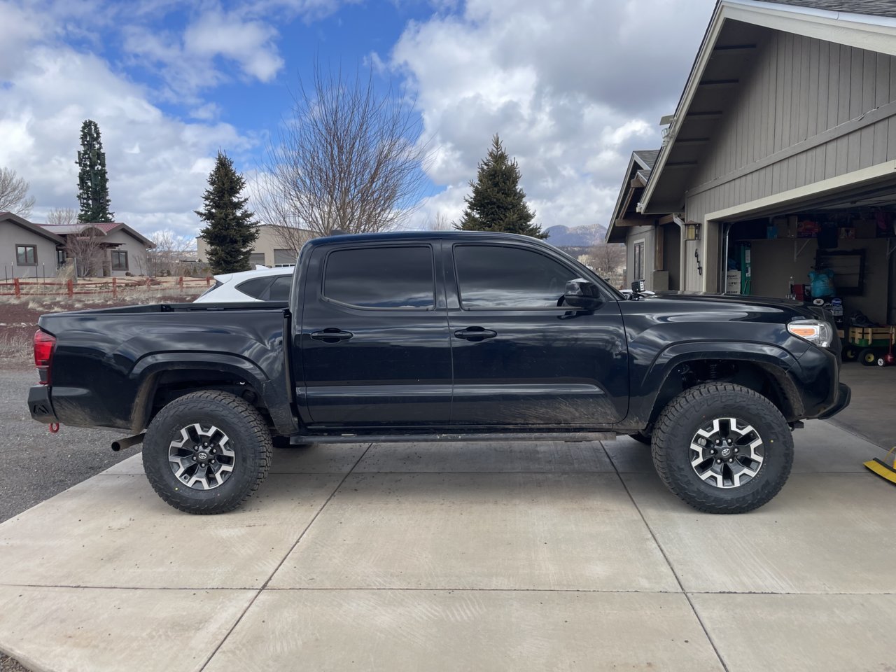

    Going to install my 5100s today, looking to fit 285 75 16s with the fifth clip and blocks
    any block you guys recommend

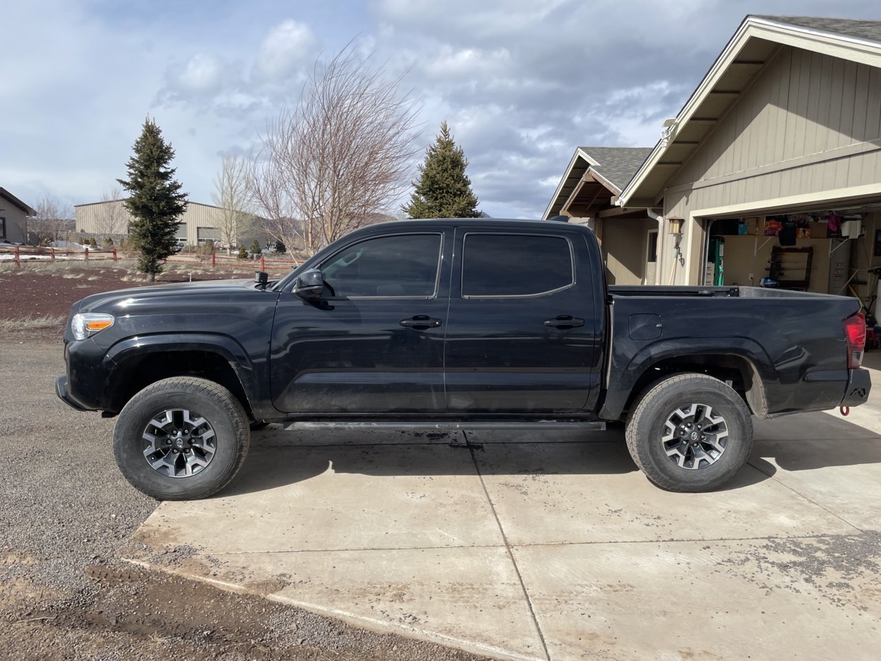

    I started at 35.5 inches from ground to wheel well on front, 36.5 on rear
    I threw on the 5100s at clip position 5. Now sitting at 37 inches in the front
    I went ahead and ordered the 1 inch toytec to balance it out.
    Another vote for the floating out the assembly instead of taking your life in your hands with a coil spring compressor.

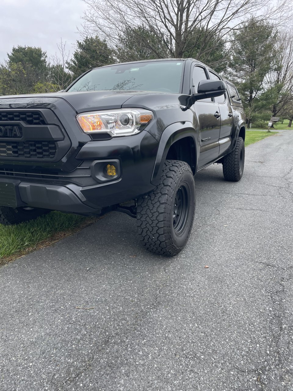

    Bilstein 5100’s set to the 5th notch on stock springs. Rear is Icon AAL with the headstrong offroad 1/2” shim for an additional 1/2” of lift.
    I can confirm that the 5th notch on stock springs provides almost exactly 2” of lift. I previously had the 2” Rough Country leveling pucks, which are just a 2” thick piece of metal. The ride height is identical with these Bilsteins as far as I can tell. A few times it has looked like the front may be a bit lower than 2” but if so, it’s probably only by a 1/4 of an inch. That also could have just been because I was not parked on level ground.
    As you can see in the pics, this is a good setup if you want your truck completely level with some weight on the back. The bed is unloaded in this pic; so there’s about 150 pounds on the rear (weight of the ARE shell).

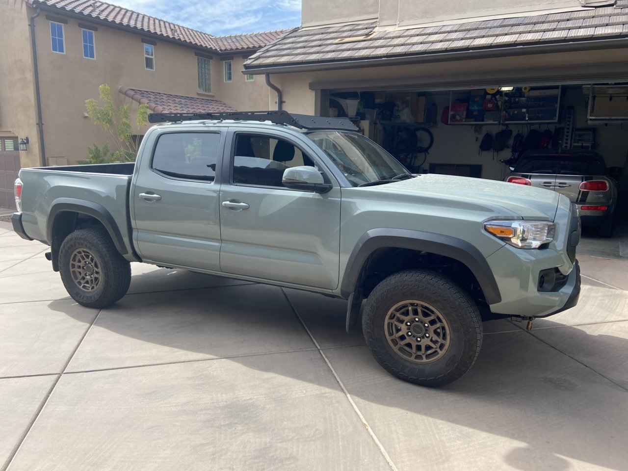

    Looking to add either 1” block or HS Deaver 1.5-2” AAL, what’s the preferred way to lift the rear. With 1” I will be setting clip to 3rd notch (1.1) so I can maintain rake. If I get the AAL I will go with the 4th clip. Don’t haul or tow anything, about 150 lbs of constant load with prinsu rack OE tonneau cover and tools. Will it be necessary to use the extended version if going to go with AAL?

    This is the same setup I have (regular 5100s all around, fronts set at 3rd notch, and Deaver AALs in the rear) and its been totally fine. To give you more confidence, I talked to the folks at Headstrong Offroad prior to my install and also bugged a number of people on here with the same setup. The consensus was its fine with the regular length 5100s.

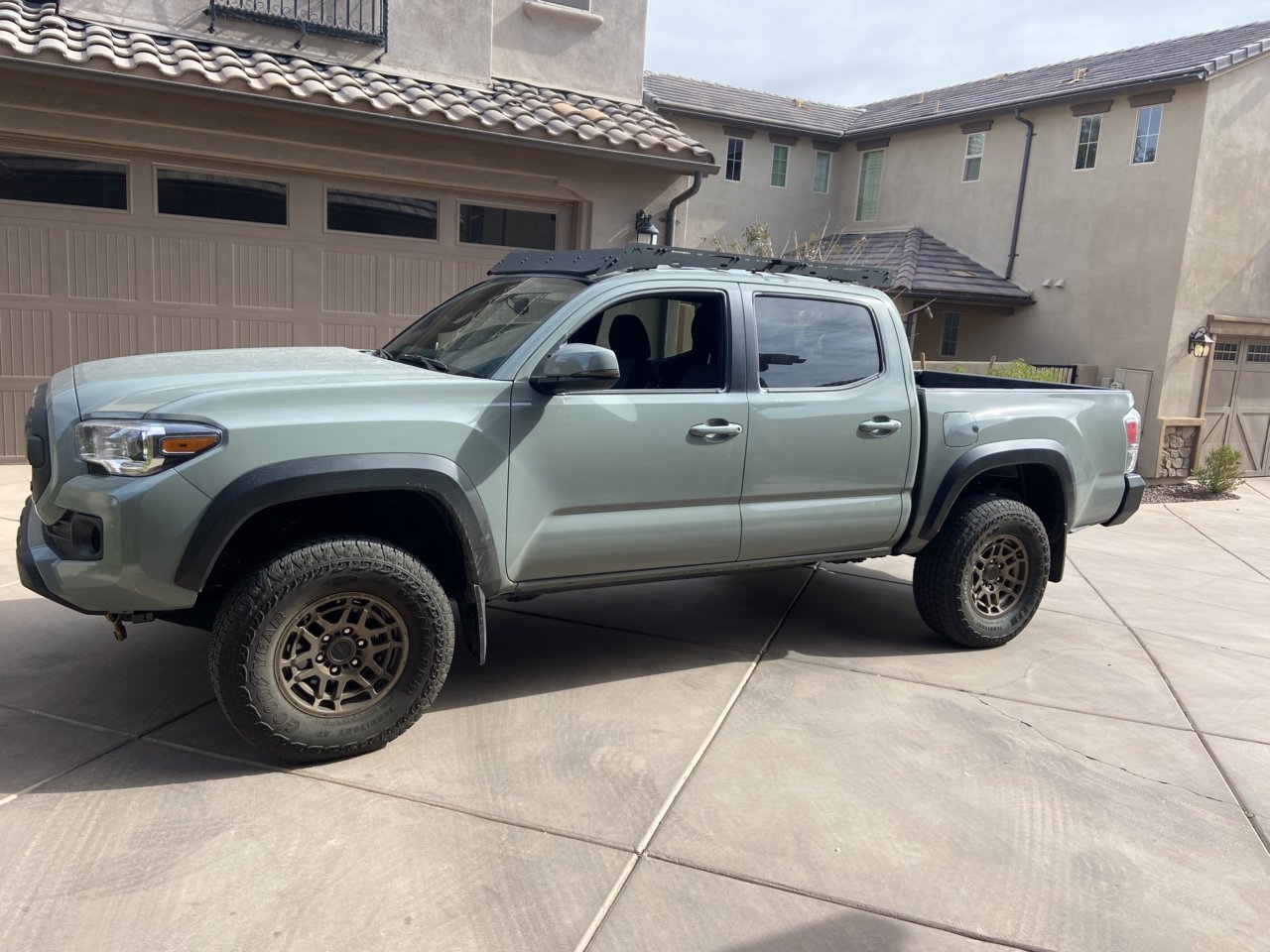

    How’s the truck look leveled? Or slight rake?
    nice! I’m leaning towards this route.

    Its leveled, went from rear fender at 36.5 inches and front at 35.5 inches to both being about 37.5 inches, front slightly lower

    Looks good thanks for the pic. I want to maintain factory rake so I’ll probably go with a single AAL
