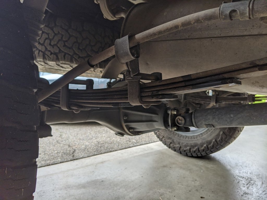

    For those of you who used the Icon 1.5" AAL spring pack, what did you do with the emergency brake cable mount that was on the overload spring?
    In Icon installation instructions, it looks like they attached it to the spring clamp on the AAL. But I don't see how that works, there's
    no way mine will reach that bolt hole. For reference:'20 DCLB Offroad
    It doesn't look like it'll cause trouble if I removed it (though DS might rub on one of the factory spring clamps a bit), looking for others experience.

    Drill it out and attach it to the keeper. You can use some channel locks or vice grips to tweak it to align. Super easy to do.

    I found a comment this morning on a Youtube video that mentioned the same thing @tonered did above. I've already done one side, the other in a bit.
