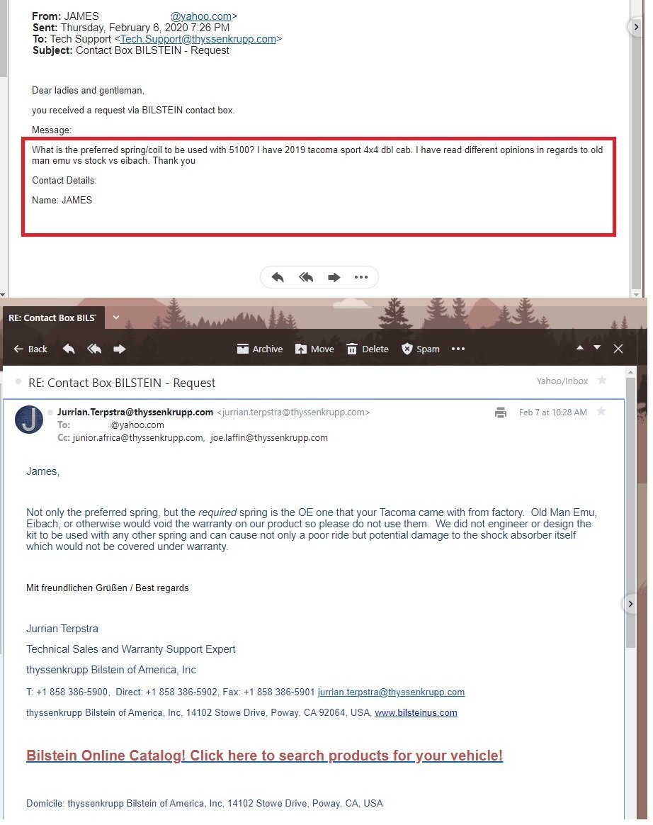

    Guess someone doesn't know everything! I was advised not to use aftermarket springs. Some do and have good success and are totally satisfied, I get that. However I have been in a truck very similar to mine and he has been through 2 sets of ome. So he is back in the factory coils, I must say the ride was better.

    Can't tell you how many times I have read where it compresses the coil. Bad info, I will listen to my local shop and Bilstein too, I mean hell they are the ones behind the 5100s.

    Personally I think it’s good news. Everyone gets to save some money and keep their warranty if the email is correct. If it’s a self install, just have a local shop put the fronts together with the springs.
    A lot of online sellers probably do that so they can sell them already together which appeals to more doing the replacement themselves.

    What's funny is this has been the stance since the beginning. But these aftermarket guys don't make much on 5100's alone so along come springs and leafs.

    I’m glad I came across this thread, honestly the first I’ve heard that. Saves money for me, and I’d have a shop do it anyways.

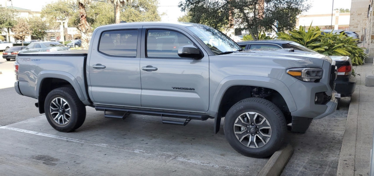

    Thank you mds08 for your suggestions, I went with the setup similar to yours. For front, I did the 5100 with stock spring on the 4th slot, and rear with 5100 and 1in block so I can get it to close leveling as possible.
    Btw, I have the 2020 TRD Sport DCSB.
    Before - Front 34 7/8, Rear 35 3/4
    After - Front 36 1/2, Rear 37
    next upgrade, TRD Sema Wheel, 17x7 with Falken AT3W 275/70R17
