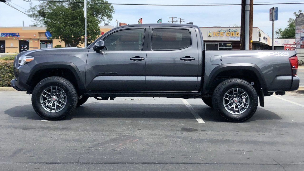

    can you share a pic from the side view?

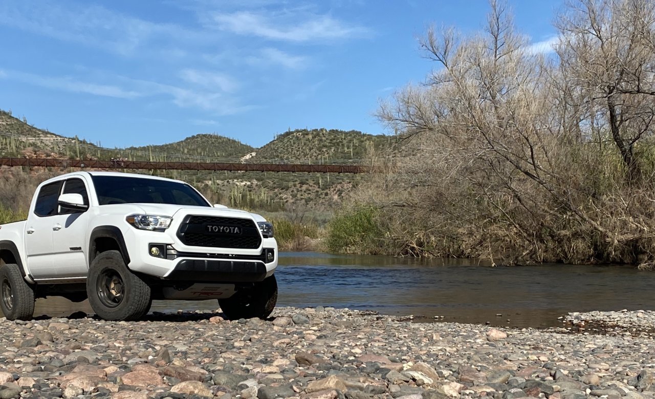

    Update a few months, and a few off roads later. Probably put 3k-5k miles on the truck since my last post and changed out the wheels. I will do tires later.
    The truck is riding great. Looks great. Performs noticeably different Offroad.
    If you use your Taco like my write up describes in my OP, I think you will be happy with this set up. Always happy to answer questions.

    [​IMG]1.1 up front stock rear

    Bilstein 5100s BFG K02 265/75 R16s
    Your Truck Looks great! Turned out nice
