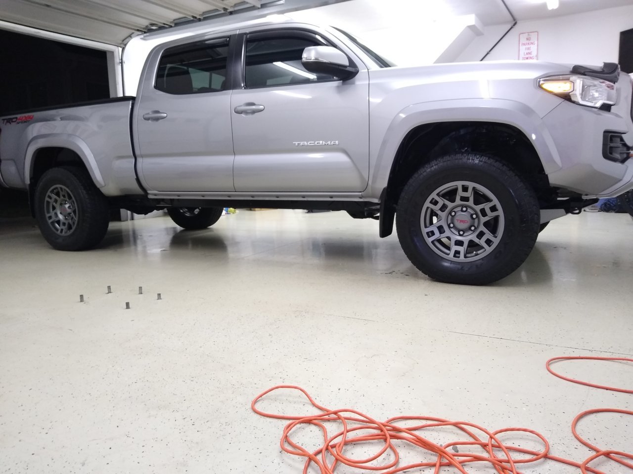

    1.1" setting, settled to 1" after driving for a week. 265/75/16 GY UT SL rated. I have about 0.500" rake now. No rub or vibrations. Toe was out a bit.

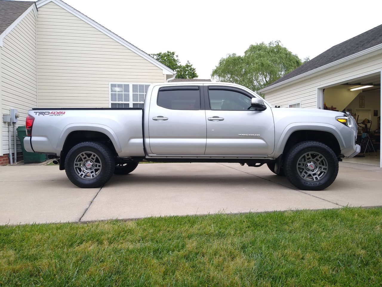

    Do you have a photo of your set up with the Bilstein at setting 4 and one-inch block in the back? I'm thinking of doing the same. Thanks!

    Bilsteins 5100s on the top setting, 4runner Gray TRD Pro Sema wheels, 285/70/17 Toyo AT3s, Sumo Bump stops, TRD exhaust, ECGS Clamshell bushing, 1/4 shim for the lean and one inch rear block, OEM Pro grill and garnish OEM TRD Skid plate, TRD CAI, Demon Brackets, Rigid Industries Pro fog lights, OEM Trail Rails sidebars, Diode Dynamics LED SL1 high and low beam lights, OEM Roof racks, Clazzio leather heated seats, Remote Start, TRD Pro shift knob, tinted windows, Rockford Fosgate 4 channel amp for the headunit and sub and amp combo, OEM Puddle lights, OEM tailgate lock, OEM bed mat, LED interior lights, OEM blackout kit for letters, JLT catch can, upgraded 27F toyota True Start battery, Vleds led tail light kit with Pro tail lights, OEM Rave4 side mirrors with convex spotters,just to name a few mods.

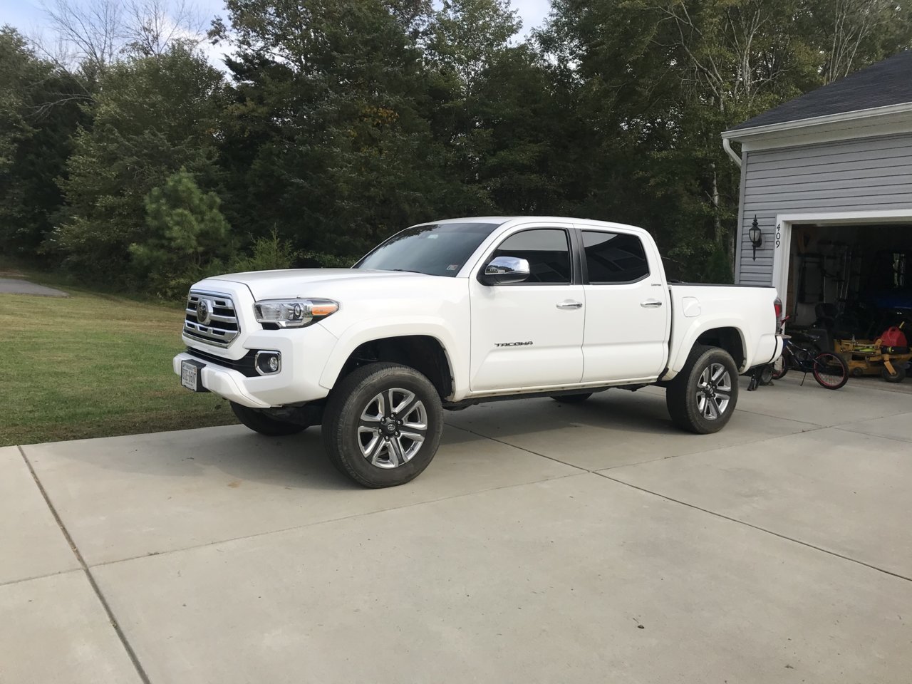

    Thank you to this tread as it helped me a lot in picking out my setup. I went with 5100s on setting 5 with stock springs and a 1” block in the back. This is it on stock wheels and tires. I will post it with new tires once they are mounted. I was worried the front would be too high but after a couple of days of driving, this front settled a lot and is nearly the same height as the rear. 67811695-0C86-432C-ADE4-AF5B7A54D9B9.jpg

    Does that truck not look like its setting nose high to you in that pic?

    It is all in his head. Our dcsb is on the fifth and still looks level too. I think his is nose high in the picture. Mine is still stilling at the same measurements today as it was two years ago after the lift andin fact this is the same spot in the garage where I measured before and after. No OME springs here. My truck rides better as it gets more miles on the Bilsteins. I drove my neighbors new 2020 DCLB sport, and my opinion mine smokes a sport factory ride all day long!
