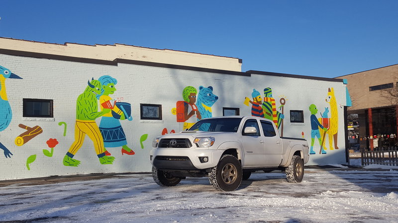

    I just put 5100s on the front of mine to level it out and reduce the rubbing I had. Didn't take any measurements, but visually it looks the way it should have been from Toyota. That is to say, it looks level.
    Stock springs, .85 setting. Slightly firmer than before but almost not noticeable.

    would you send a picture?

    Only thing I have at the moment...
