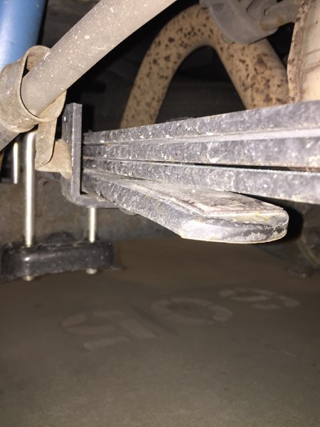

    If you have either 4, or 6 clips you don't need new springs.
    Judging by the picture, it looks like if you have the 2+1's with 4 clips, or the 3+1's with 6 clips your GTG. The latest round of replacements have been the 3+1 with 6.

    Some folks were saying that if you had the TSB warranty done that adds a leaf you should use the 1.75 setting I assume bc the extra leaf adds some height. Are they talking about the same things as the recall? I did have that done but I'm not sure if they added a leaf or just added more clips
    hold on a sec, I just checked and there are 6 clips...just not sure if they added a leaf when they did the recall or not.

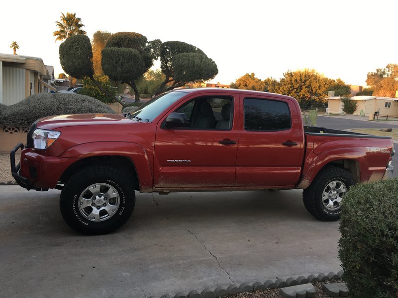

    Got the 5100's last week and set them to .85 the ride is amazing regret not getting them earlier the ride is firmer but not in a bad way. They soak up potholes a whole lot better then the stock shocks. Even noticed less body roll. I bought mine off wheelers off road with the 1/4 inch spacer. I highly recommend their front bump stops to
    Truck might look nose high do to the driveway having a slope

    Your half right. A TSB is not a recall. The purpose of the TSB is to alert the dealerships of a known issue, and if a warranty customer complains of that issue, there is typically a known fix for it. A recall is more of a blanket campaign that is sent out to everyone affected, even people like me, who have been out of warranty for years.
    Even though everyone calls this last batch of springs "TSB" springs, they're actually "Recall" springs. A few years ago there was a TSB put out for people complaining of bottoming out. If they were under warranty, they got replaced under the TSB.
