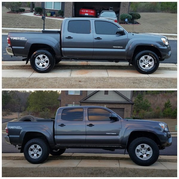

    Screenshot_20170122-105407.jpgbilsteins set at 1.75 and 2" add a leaf on rear.
    Fitz235 likes this.
  17. Jan 29, 2017 at 6:10 PM
    #57
    G3rm205
    G3rm205 Member
    Dec 25, 2016
    #205678
    17
    Larry
    Bama
    2014 TRD OFF RD 4x4 DCSB

    @G3rm205
    What size are your tires with lift?
  19. Jan 30, 2017 at 6:01 AM
    #59
    G3rm205
    G3rm205 Member
    Dec 25, 2016
    #205678
    17
    Larry
    Bama
    265/75/16 toyo AT
