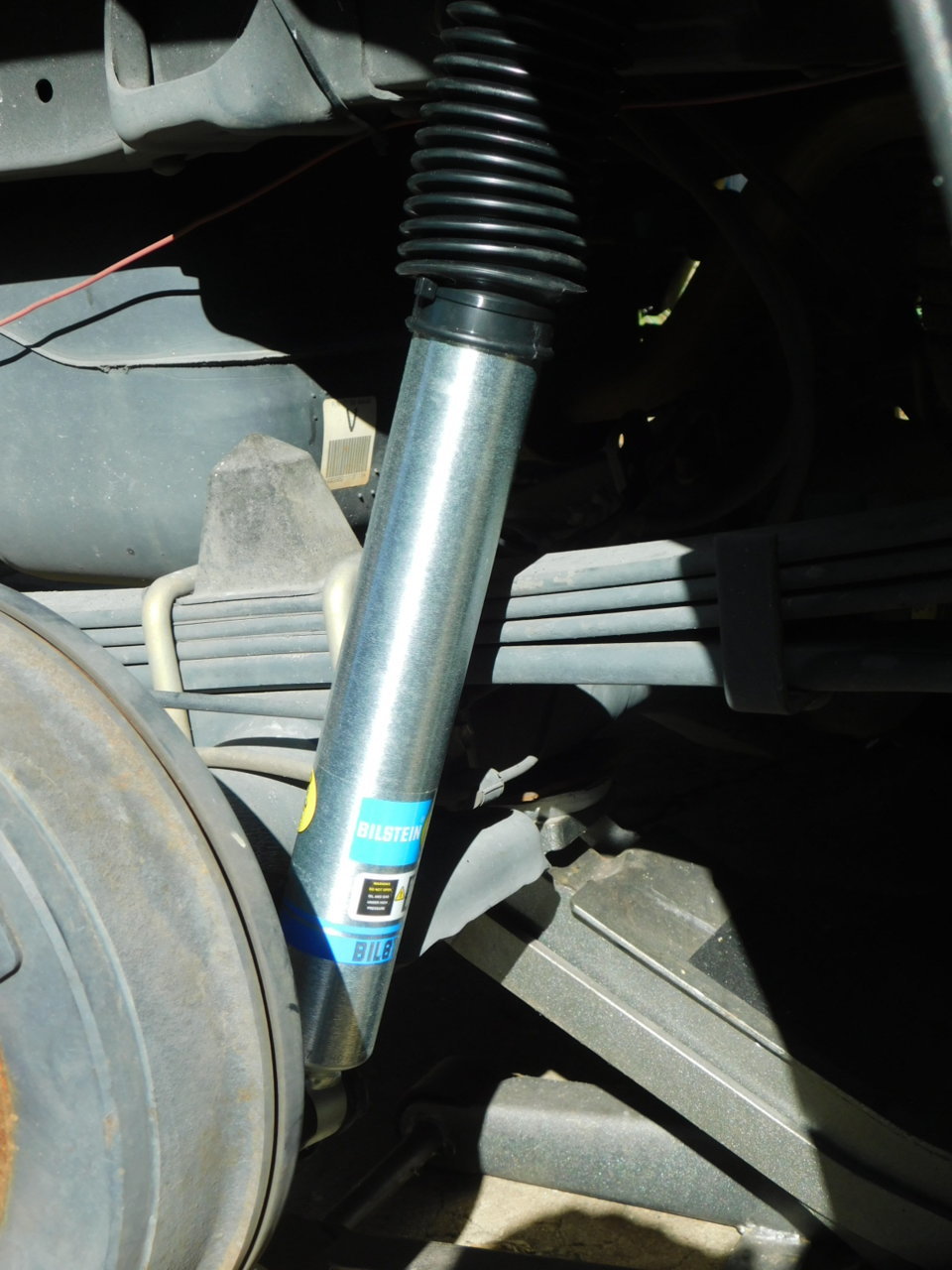

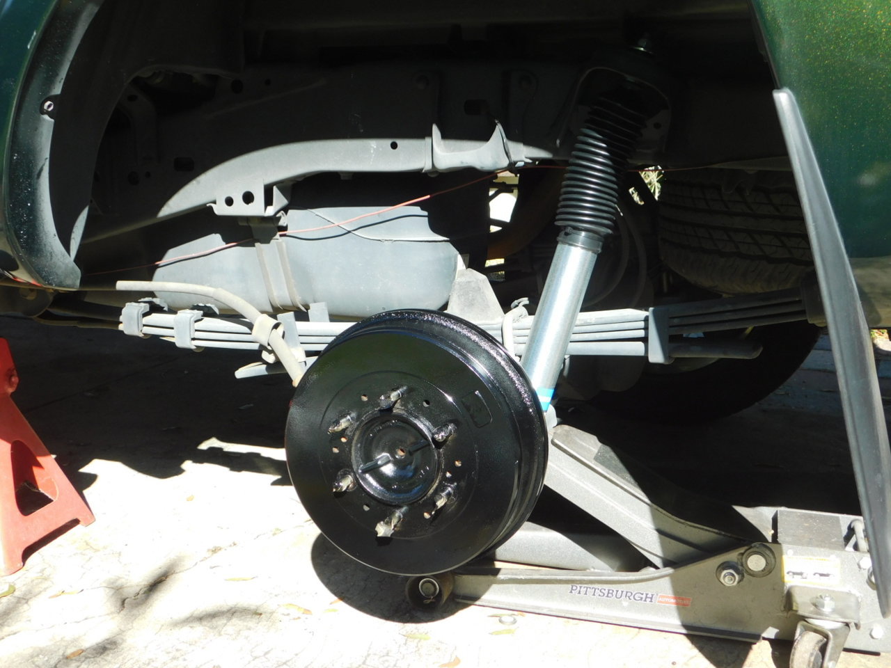

    Installed my 5100's in the rear of my 12 dcsb v6 today. I have had them for several months
    just awaiting time to get them put on. Boy did they ever need it . The old stock shocks
    were spent. Rebound from fully compressed was about 7 minutes. And the entire shock
    could be compressed easily. I'm glad to get this done. Gained a little ride height too.
    Install was easy - I soaked the hardware with PB Blaster a week prior to doing the work
    this morning. Everything came off without issue. I repainted my brake drums while the
    wheels were off. Adding to the upgrade and appearance. I'm saving up now for the front
    ones next .
