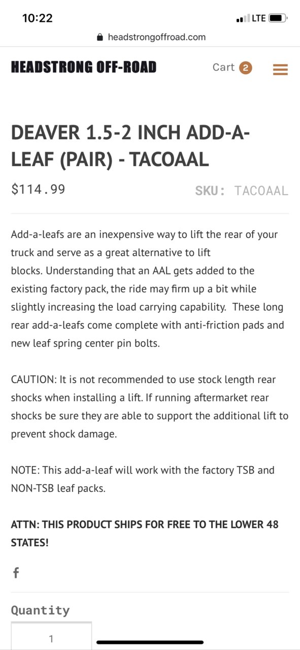

    Wait, standard length 5100s in the rear or extended with a single leaf AAL? It’s literally says on their website NOT to use any AALs with standard length rears. Not sure if that’s changed or not but interesting as I’d like to do that as well so long as I’m not bottoming out the shock and damaging them.
    @HeadStrong Off-Road can you clarify? Thanks!

    I was just told by Headstrong that the extended length rears are for lifts >3", they recommended I use the standard length 5100s with my 1.5" blocks

    Gotcha, was confusing because of this..

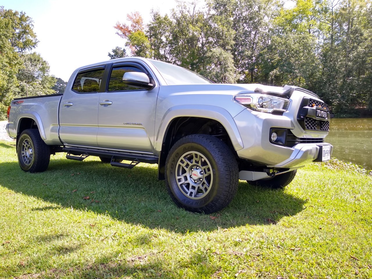

    I must be one of the lucky ones. Mine is on the 4th notch and a one inch rear block. The ride is great, no vibrations,shakes or any issues what so ever. I did the front diff drop and a rear drop as well. Alignment is spot on. The top settings only give a little more than 2 inches. IMG_20190915_115854922_HDR.jpg

    Marie at Headstrong sent this to me, it describes what lift you can safely use wirh 5100’s in the rear. I went with a single leaf AAL Deaver which kept mine within the extended range of the 5100’s:
    “Rear shocks work a little differently. When sourcing rear shocks it is recommended to know what the extended and collapsed length of the shock is and how that works with the rear lift you are going with. For example the standard length Bilstein 5100 rear shocks are spec’d out for a 0-1” rear lift. They have a 14.02 collapsed and a 22.94 extended. You can utilize them for lifts outside of that range. It is how you are achieving lift that largely plays into this. Those shocks will work with an 1.5”-2” add-a-leaf lift because the add-a-leaf is only around 1/4”-3/4” thick but it re-arches the factory pack thus providing that much more lift. They will also work with blocks up to around 1.5” as well.

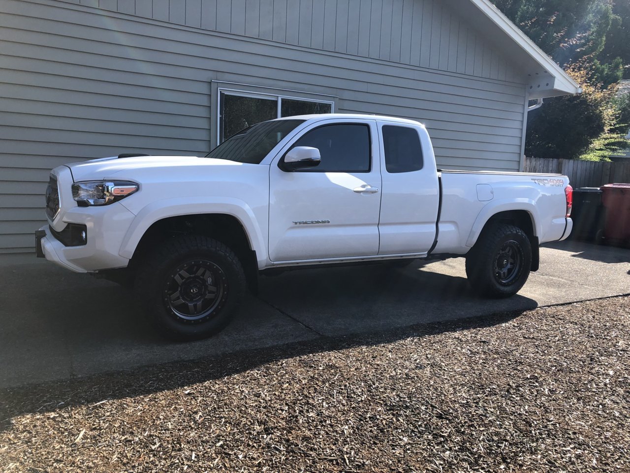

    7E485BB5-D911-41B9-9783-8FDD06CB3126.jpg 2019 TRD sport Bilstiens 5100 front and rear set at 1.1 inch and that makes the frt. 1/2 higher than the back.
