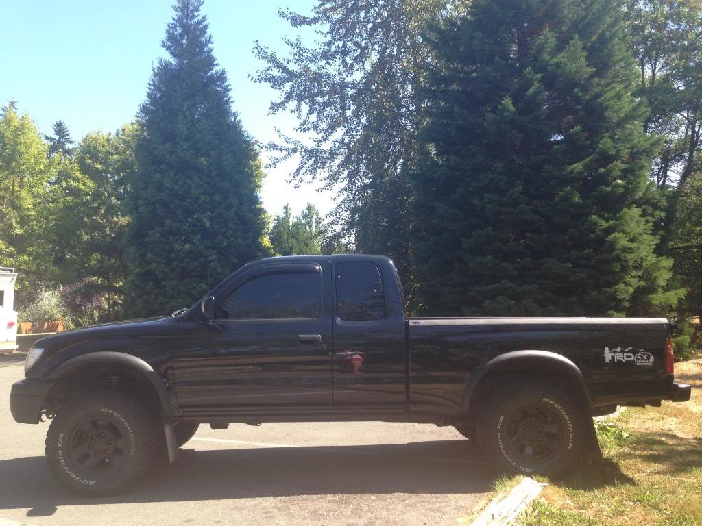

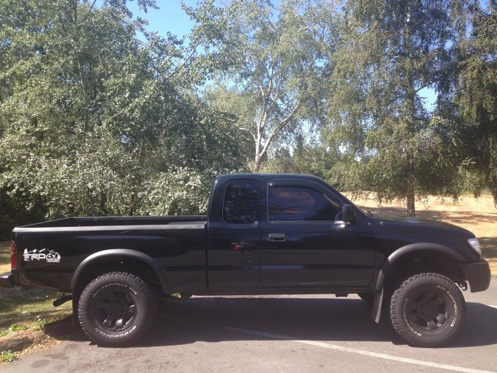

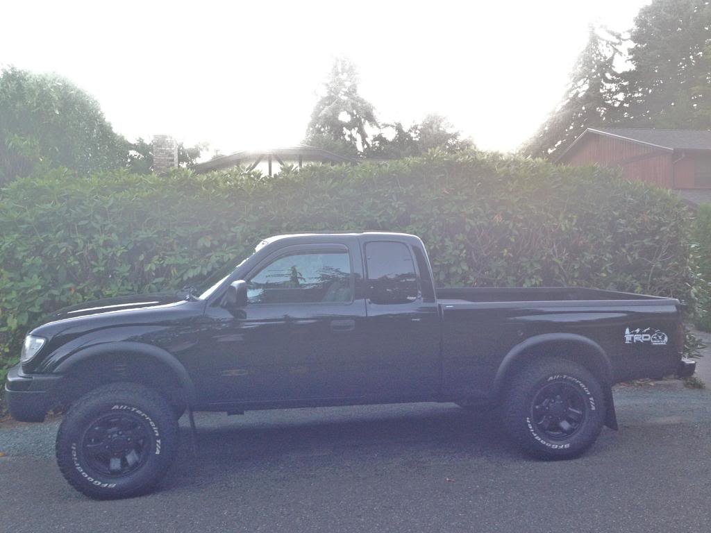

    Here are some pictures of my bro lean (3" eibachs with stock in the back) I didn't get my All-Pro expo leafs due to error on their part so I was stuck with the bro lean for over a month :eek:
    I'm gonna reiterate, bro lean sucks... and you feel like a douchebagel rollin' around with the nose up in the air.... but it's your truck so do what you will! :D
