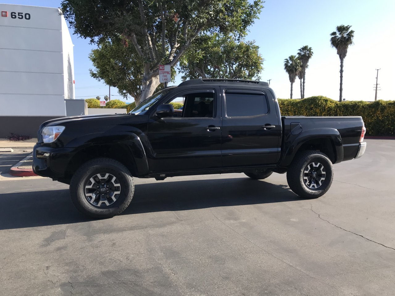

  17. Jun 6, 2021 at 9:55 PM
    #17
    thegrandpoohbah
    thegrandpoohbah [OP] Well-Known Member
    Jan 3, 2010
    #28718
    289
    Terrace, BC, Canada
    2013 4x4 Double Cab V6 TRD Sport
    Here is my before pic. The truck goes in to the shop on Wednesday for the new suspension!
