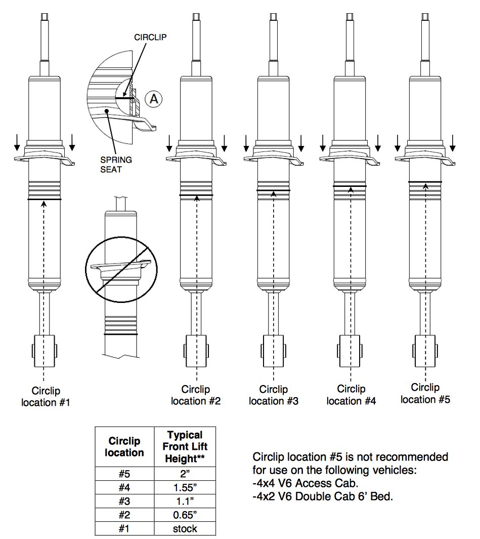

    Am I wrong to think that lifting the truck on the backs of the 5100s without the proper support of a matched coil, will significantly shorten the lifespan of the billies?

    Thank you. I’m on top setting. With an 1.5” aal in rear. No complaints here. Ive done light trails and is a daily driver. Since I’ve had lift it definitely has softened up a little. You definitely can’t beat 5100’s.

    I appreciate the response. No ill side effects from the top setting? Seems your pretty satisfied with the ride.
    I was going to go with 6112/5160s or Elka 2.0s but a local guy I know just sold me brand new, in box, 5100s front & rear, for $200. I went ahead and grabbed them for that price. I think Im just going to go ahead and install them and see what I think.

    Exactly give it a shot. I was on the fourth setting and moved up no difference IMO. Also I was going to use OME COIL Springs but saw how many guys were getting sagging. So I stuck with oem coils. I did some research. Talked to Bilstein direct. They do have a settings sheet for height adjustments.

    Also remember that 2” seems to be the line between just doing shocks and AAL and having to start doing other mods. Over 2” might mean a diff drop or changing other items to avoid vibrations. I have no vibration at any speed right now.
