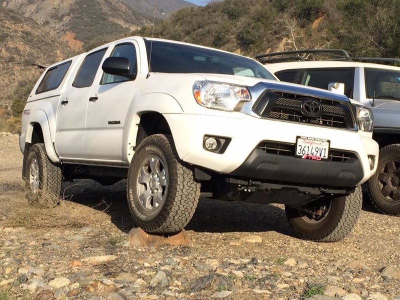

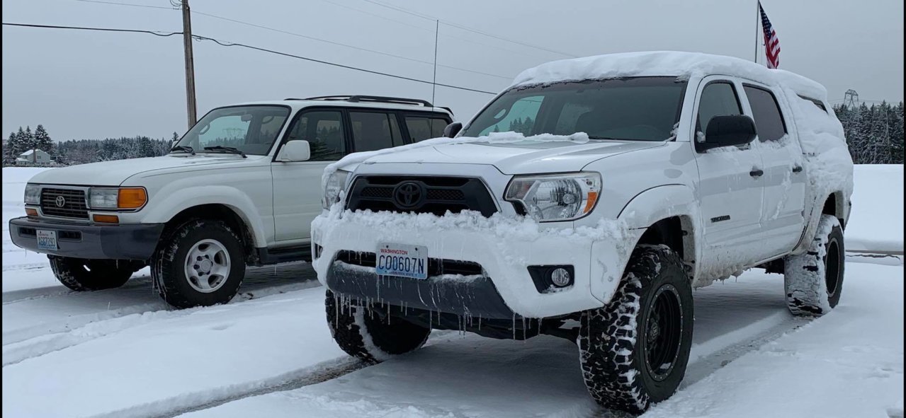

    I just had Bilstein 5100's set at "0" and OME 885x's installed 5 days ago. The front of my truck went up 2 1/2 inches like expected. If it went to 3" or over I would have needed UCA's ect.
    My truck rides better, stiffer in front not soft and when braking there is no dipping forward. I love it.
    Off road is great and comfortable.
    This is the recommended setting for the Bilstein 5100's set at "0" and OME 885x's.
    ****** It is the 885's that give you the lift *****
    I know I am safe at this height and will not damage anything or my warranty.
    For me it just makes sense.
    ICON Alpha wheels and BFG 285 70 17's BMC and pinch welds done.
